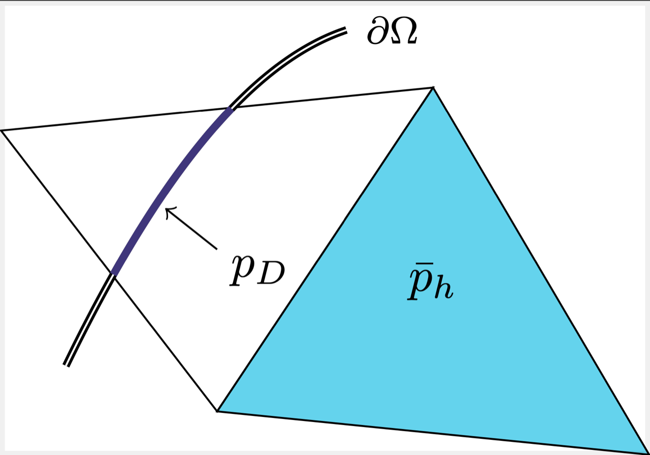

On each patch \(\omega\) with subtriangulation \(\mathcal{T}_\omega\), we want to find \(p_h^\ast \in \mathbb{P}^{k+1}(\mathcal{T}_\omega)\) so that \begin{align} (\nabla p_h^\ast, \nabla q_h^\ast)_{\Omega \cap \omega} + j_h^\omega(p_h^\ast,q_h^\ast) &= (u_h,\nabla q_h^\ast)_{\Omega \cap \omega} \qquad \forall q_h^\ast \in \mathbb{P}^{k+1}(\mathcal{T}_\omega) \setminus \mathbb{R} \tag{P1-local} \\ (p_h^\ast,1)_{\omega \cap \Omega^{\text{int}}} &= (\bar p_h,1)_{\omega \cap \Omega^{\text{int}}}. \tag{P2-local} \end{align} Here \(j_h^{\omega}(\cdot,\cdot)\) is a patch-local ghost penalty with an \(H^1\) (instead of \(L^2\)) scaling.
We can reformulate this as a global problem on the whole mesh, especially the integral constraint, with the help of a Lagrange multiplier \(\lambda \in \mathbb{P}^0(\mathcal{T}_h^{\text{int}})\): Find \(p_h^s \in \mathbb{P}^{k+1}(\mathcal{T}_h)\) and \(\lambda \in \mathbb{P}^0(\mathcal{T}_h^{\text{int}})\) so that \begin{align} (\nabla p_h^\ast, \nabla q_h^\ast)_{\Omega} + j_h^\omega(p_h^\ast,q_h^\ast) + (q_h^\ast,\lambda)_{\mathcal{T}_h^{\text{int}}} &= (u_h,\nabla q_h^\ast)_{\Omega} \qquad \forall q_h^\ast \in \mathbb{P}^{k+1}(\mathcal{T}_h) \tag{P1} \\ (p_h^\ast,\mu)_{\mathcal{T}_h^{\text{int}}} &= (p_h^\ast,\mu)_{\mathcal{T}_h^{\text{int}}} \qquad \forall \mu \in \mathbb{P}^0(\mathcal{T}_h^{\text{int}}). \tag{P2} \end{align}

  1. How to deal with the r.h.s. if it is not provided on the active mesh, but only on \(\Omega\)
  2. An alternative post-processing that work element-by-element in case that a ghost penalty stabilization has been used before

Instead of assuming \(f\) to be given on the whole active mesh, we can also use the ghost penalty stabilization to construct an approximation \(f_h\) of \(f\) by a discrete extension. For \(\gamma_f > 0\), we find \(f_h \in \mathbb{P}^{k_f}(\mathcal{T}_h)\), \(k_f \in \mathbb{N}_0\), by solving \begin{equation} (f_h,q_h)_{\Omega} + \gamma_f j_h (f_h,q_h) = (f,q_h)_{\Omega} \qquad \forall q_h \in \mathbb{P}^{k_f}(\mathcal{T}_h). \end{equation}
This problem can be solved patch-by-patch if \(j_h(\cdot,\cdot)\) decouples across patches. The following code implements this approximation using patch-wise solves.

If \(u\) is well approximated not only on \(\Omega\), but on the whole active mesh, i.e. if GP stabilization has been used, a simpler element-by-element post-processing scheme is possible.
By making use of the relation \(u=\nabla p\), we can repair the inconsistencies of the approximation of \(p\) and achieve higher order convergence. For each element \(T \in \mathcal{T}_h\), we want to find \(p_h^\ast \in \mathcal{P}^{k+1}(T)\) such that \begin{alignat}{2} (\nabla p_h^\ast, \nabla q_h^\ast)_T &= (u_h, \nabla q_h^\ast)_T \qquad &&\forall q_h^\ast \in \mathcal{P}^{k+1}(T)\\ (p_h^\ast,1)_T &= (\bar p_h,1)_T \qquad &&\text{if } T \in \mathcal{T}_h^{\text{int}}\\ (p_h^\ast,1)_{T \cap \partial \Omega} &= (p_D,1)_{T \cap \partial \Omega} \qquad &&\text{if } T \in \mathcal{T}_h^{\text{cut}}\\ \end{alignat}

p += grad(ps) * grad(vs) * dxbar
p += (lam * vs + mu * ps) * dxinner
p += (lam * vs + mu * ps) * ds
# R.h.s. term:
pf = LinearForm(Zh)
pf += gfu * grad(vs) * dxbar
pf += p_exact * mu * ds
pf += gfpT * mu * dxinner
#Assembly
p.Assemble()
pf.Assemble()
#Solving the system
gfz.vec.data = p.mat.Inverse(Zh.FreeDofs(),inverse="umfpack") * pf.vec
#For visualization:
gflh.Set(p_exact, definedonelements=ci.GetElementsOfType(HASNEG))
gflam.Set(gfps, definedonelements=ci.GetElementsOfType(HASNEG))
DrawDC(lsetp1,gfps,-1,mesh,"p",deformation=deformation, min=-1, max=1)        # p on physical domain
ps_l2error = sqrt(Integrate((gfps - p_exact)**2*dX.order(2*order+3), mesh))
print("ps_l2error = ", ps_l2error)
ps_l2error =  3.9763099115826354e-06
