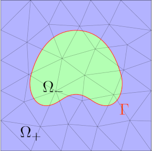

We want to solve a geometrically unfitted model problem for a stationary domain.
We use a level set description (cf. basics.ipynb):
\[\Omega_{-} := \{ \phi < 0 \}, \quad \Omega_{+} := \{ \phi > 0 \}, \quad \Gamma := \{ \phi = 0 \}.\]
and use a piecewise linear approximation as a starting point in the discretization (cf. intlset.ipynb for a discussion of geometry approximations).

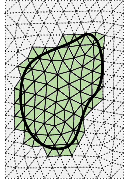

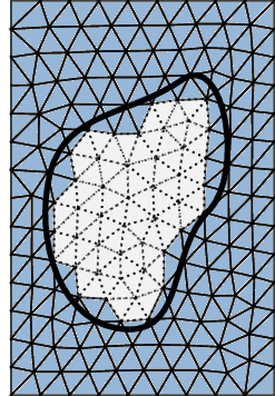

For the discretization we use standard background FESpaces restricted to the subdomains:
\[V_h^\Gamma \quad = \qquad V_h |_{\Omega_-^{lin}} \quad \oplus \quad V_h |_{\Omega_+^{lin}}\]
composed
inner
outer
spaceboth
spaceinner
spaceouter
In NGSolve we simply take the product space \(V_h \times V_h\) but mark the irrelevant dofs using the CutInfo-class:

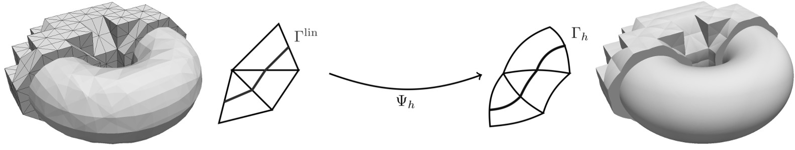

In the previous example we used a second order FESpace but only used a second order accurate geometry representation (due to \(\phi_h^{lin}\)).
We can improve this by applying a mesh transformation technique, cf. intlset.ipynb:
lsetcurv
