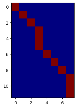

L2 low order
Let us try it out for the space of piecewise constants first:
fes = L2(mesh, order=0)
E = AggEmbedding(EA, fes)
from helper import ShowPattern
ShowPattern(E)
print(E)
../../_images/i-tutorials_unit-8.8-aggregation_aggregation_21_0.png
Row 0:   0: 1
Row 1:   1: 1
Row 2:   2: 1
Row 3:   3: 1
Row 4:   3: 1
Row 5:   3: 1
Row 6:   4: 1
Row 7:   5: 1
Row 8:   6: 1
Row 9:   7: 1
Row 10:   7: 1
Row 11:   7: 1

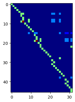

L2 higher order
Now, higher order:
fes = L2(mesh, order=2)
ShowPattern(AggEmbedding(EA, fes))
gfshow = ExtendedBasisFunctionsAsMultiDim(EA,fes)
Draw (gfshow, mesh, interpolate_multidim=False, animate=False, autoscale=True);

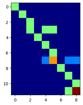

H1
When considering spaces with (partial) continuity, some dofs may appear in several patches but not on a root element. In this case the extensions are average:
fes = H1(mesh, order=1)
../../_images/i-tutorials_unit-8.8-aggregation_aggregation_29_0.png

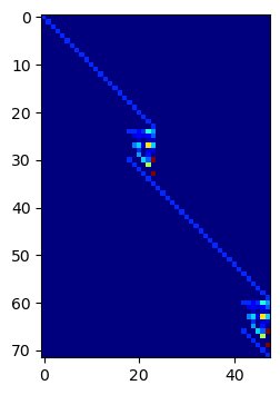

Vector-valued spaces
And now, HDiv
fes = HDiv(mesh, order=1)
../../_images/i-tutorials_unit-8.8-aggregation_aggregation_31_0.png
