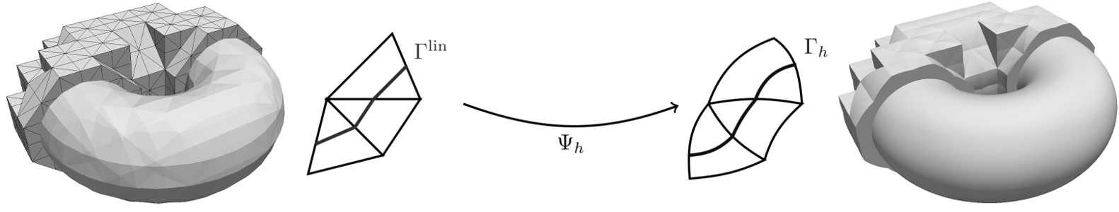

Higher order geometry approximation with an isoparametric mapping
In order to get higher order convergence we can use the isoparametric mapping functionality of xfem.
We apply a mesh transformation technique in the spirit of isoparametric finite elements: title
Video of the mesh transformation

To compute the corresponding mapping we use the LevelSetMeshAdaptation class
mesh = Mesh(square.GenerateMesh(maxh=0.4, quad_dominated=False))
lsetmeshadap = LevelSetMeshAdaptation(mesh, order=2, threshold=1000, discontinuous_qn=True)
Draw(deformation,mesh,"deformation")
We can observe the geometrical improvement in the following sequence:
scene1 = Draw(deformation, mesh, "deformation", autoscale=False, min=0.0, max=0.028)
scene2 = DrawDC(lsetmeshadap.lset_p1, -3.5, 2.5, mesh, "lsetp1_ho", deformation=deformation)
