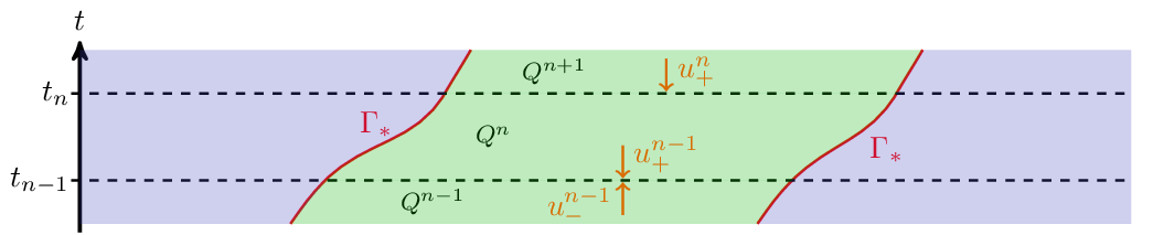

Upwind DG in time
In order to impose weak continuity in time, an upwind stabilisation is added, yielding
\begin{equation*} (\partial_{t} u, v)_{Q^n} + \alpha (\nabla{u},\nabla{v})_{Q^n} + (w \cdot \nabla{u},v)_{Q^n} + (u_{n−1}^+,v_{n−1}^+)_{\Omega^{n−1}} = (f,v)_{Q^n} + (u_{n−1}^-,v_{n−1}^+)_{\Omega^{n−1}}. \end{equation*}
limits-time-slab

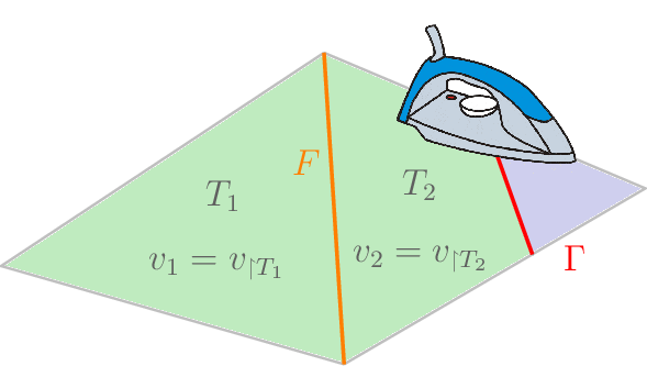

Ghost penalty stabilization
To gain sufficient control on all space-time d.o.f.s we add a so-called Ghost-Penalty stabilization as in [1]. Adding the stabilization, the variational formulation on the time slabs becomes:
\[\begin{split}\text{with} \qquad\qquad s_h(u,v) = \sum\limits_{F \in F_{h}}{ \gamma_{j} \int\limits_{t_{n-1}}^{t_{n}}{ \int\limits_{\omega_F}{ h^{-2} [\![ u]\!] \, [\![ v]\!] \, d\mathbf{x} \, dt. } } } \\\end{split}\]
where \([\![u]\!]\) is the difference of \(u|_{T_1}\) and \(u|_{T_2}\) (interpreted as polynomials \(\in \mathbb{R}^d\)) and \(F_h\) is the set of facets on which the stabilization shall be applied. macro-element
