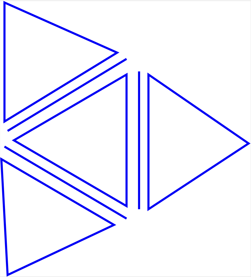

The hybrid DG method:
Alternative text
On \(V_h = V_T \times V_F = P^k({\mathcal T}) \times P^k ({\mathcal F})\) we define the bilinear form
\[\DeclareMathOperator{\Div}{div} \sum_T \int_T \nabla u \nabla v - \sum_T \int_{\partial T} \tfrac{\partial u}{\partial n} (v-\widehat v) - \sum_T \int_{\partial T} \tfrac{\partial v}{\partial n} (u-\widehat u) + \frac{\alpha p^2}{h} \sum_F \int_F (u-\widehat u)(v-\widehat v)\]
Element variables can be condensed out, which leads to a system reduced to the Skeleton.
When splitting a large triangle \(T_H\) into small trianles, the functions on \(\partial T_H\) have a canonical representation on the facets of the fine triangles. However, facet variables on internal edges of \(T_H\) are not defined by embedding. The HarmonicProlongation provides the energy optimal extension to the internal edges. To define energy optimal we need the energy defined by a bilinear form.
