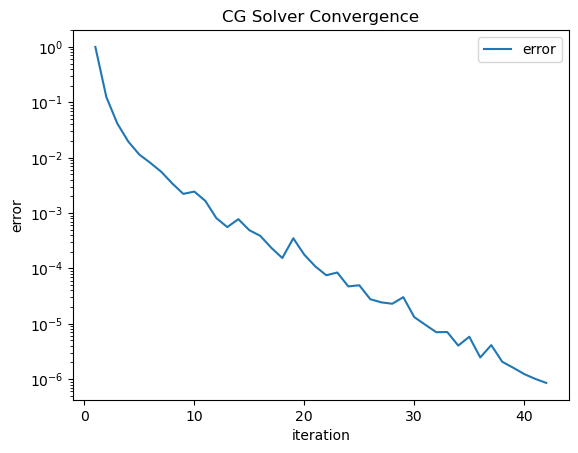

The single layer potential LaplaceSL provides this discretization matrix as a linear operator when it is multiplied by the test function integral. It uses Sauter-Schwab numerical integration for the singular integrals and the fast multipole method for the far field interaction.
from ngsolve.bem import LaplaceSL
fesL2 = SurfaceL2(mesh, order=4, dual_mapping=True)
u,v = fesL2.TnT()
    V = LaplaceSL(u*ds)*v*ds
    lf = LinearForm(1*v*ds).Assemble()
    pre = BilinearForm(u*v*ds).Assemble().mat.Inverse(inverse="sparsecholesky")
    inv = solvers.CGSolver(V.mat, pre, tol=1e-6, printrates=False, plotrates=True)
    gfurho = GridFunction(fesL2)
    gfurho.vec.data = inv * lf.vec
../../_images/i-tutorials_unit-11.1-fmm_layerpotentials_18_0.png
<Figure size 640x480 with 0 Axes>
The solution shows strong singularities at the boundary of the shield:
