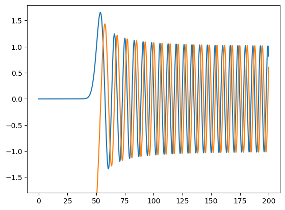

Looking hat these functions at large index \(n\) shows the interesting behavior:
from scipy.special import spherical_jn, spherical_yn
x = np.linspace(0,200, 1000)
plt.ylim(-1.8,1.8)
plt.plot (x, x*spherical_jn(50, x))
with np.errstate(invalid='ignore'):
    plt.plot (x, x*spherical_yn(50, x));
For \(x > n\), both Bessel functions are oscillating, with amplitudes decreasing like \(1/x\). For \(x < n\), the \(j_n\) are extremely small, while \(y_n\) are extremely large. This explains the unstable behaviour of the recursion for the \(j_n\). We use the recusion in \(n\). For \(n \leq x\), the \(j_n\) are \(O(1)\), but for \(n > x\) they become very small. Unavoidable roundoff errors for small \(n\) lead to huge relative errors for the higher \(n\). High quality implementations compute the recurrence backward, where it is stable, and also take care of leaving the range of floating point numbers, see e.g. the implementation from FMM3D on github
