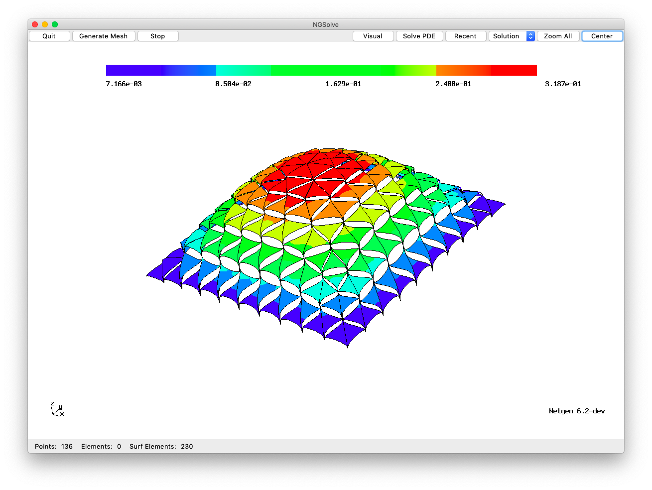

Using the BDDC preconditioner:
For the BDDC (balancing domain decomposition with constraints) preconditioning, we build a FEM system with relaxed connectivity:
f7cc17d8b7f74eb0bda9dc87cba0ca2e
This allows for static condensation of all local and interface degrees of freedom, only the wirebasket dofs enter the global solver. The resulting matrix \(\tilde A\) is much cheaper to invert.
The preconditioner is
\[P = R {\tilde A}^{-1} R^T\]
with an averagingn operator \(R\).
