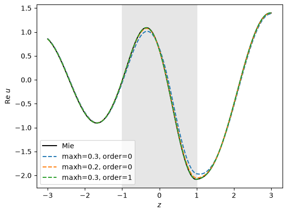

cases = [(0.3, 0), (0.2, 0), (0.3, 1)]
print (" maxh  order  ndof  its  u_in+u_s   u_h")
uzs = []
for h, order in cases:
    mesh = Mesh(OCCGeometry(Sphere((0,0,0), 1)).GenerateMesh(maxh=h)).Curve(2)
    gfu, its = SolveLS(mesh, m, k, order)
        uz = np.exp(1j*k*zs) + ScatteredField(gfu, m, k)(zaxis)[:,0]
    uzs.append(uz)
    uh = gfu(mesh(0*zin, 0*zin, zin))[:,0]
    print (f" {h:4.2f}  {order:5d}  {gfu.space.ndof:4d}  {its:3d}  "
           f"{err(uz[inner], uz_mie[inner]):.2e}  {err(uh, uz_mie[inner]):.2e}")
 0.30      0   422   12  7.40e-02  3.60e-01
 0.20      0  1709   11  1.63e-02  1.17e-01
 0.30      1  1688   11  3.92e-03  6.77e-02
plt.plot(zs, uz_mie.real, "k", label="Mie")
for (h, order), uz in zip(cases, uzs):
    plt.plot(zs, uz.real, "--", label=f"maxh={h}, order={order}")
plt.axvspan(-1, 1, color="0.9"); plt.xlabel("$z$"); plt.ylabel("Re $u$"); plt.legend();

The table compares, for \(k = 2\) and \(\eta = \sqrt 2\), the total field \(u_{in} + u_s\) and \(u_h\) itself with the Mie series on the \(z\)-axis inside \(D\). Total field on the plane:
