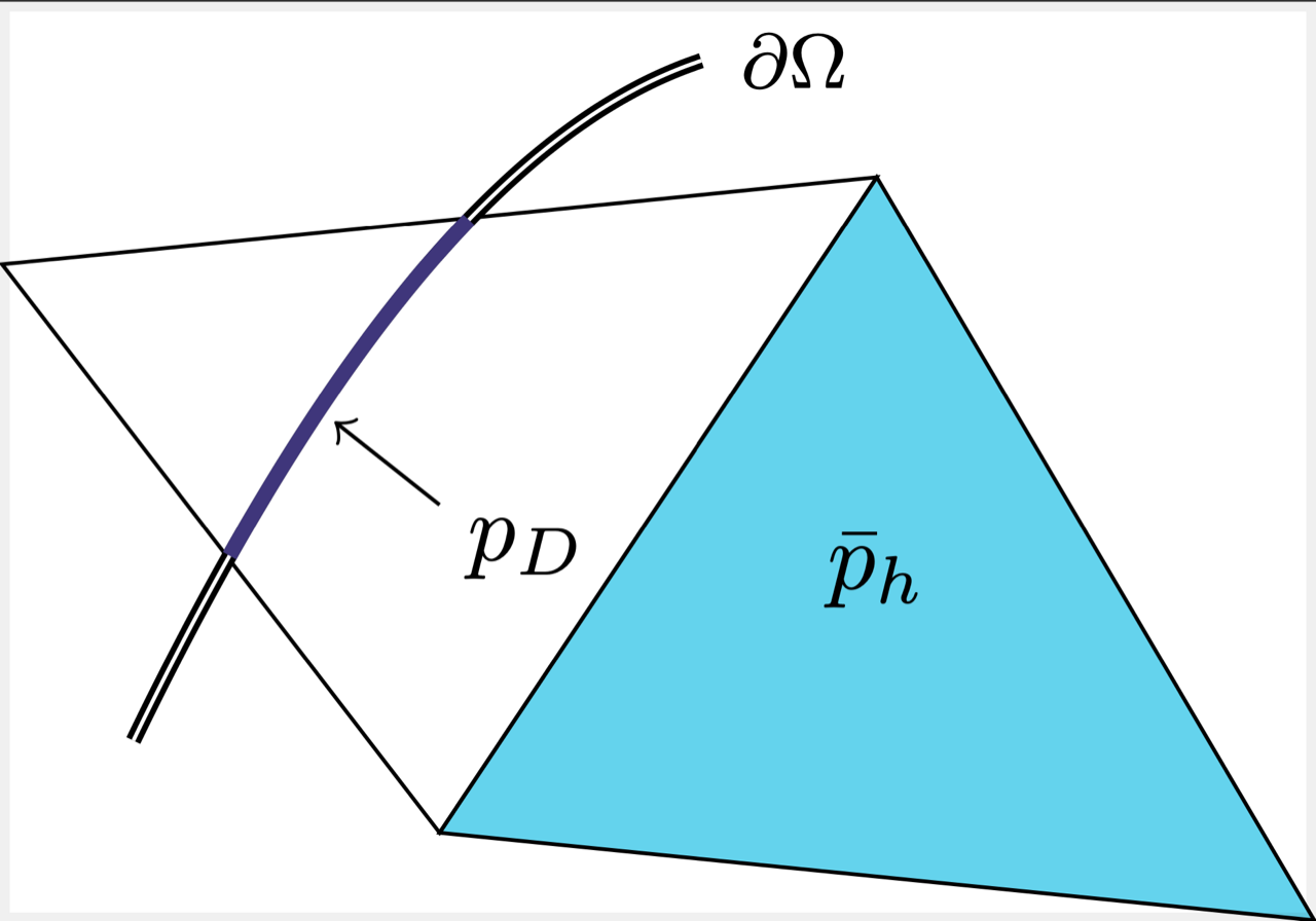

Our goal is to consider the mixed Poisson problem with Dirichlet boundary conditions in an unfitted setting: Find \(u: \Omega \rightarrow \mathbb{R}^d\), \(p : \Omega \rightarrow \mathbb{R}\) such that
\begin{alignat}{2} u - \nabla p &= \phantom{-} 0 \quad &&\text{in } \Omega, \tag{C1}\\ \operatorname{div} u &= -f \quad &&\text{in } \Omega, \tag{C2} \\ p &= \phantom{-} p_D \quad &&\text{on } \partial \Omega. \tag{C3} \end{alignat}
Here \(\Omega \subset \mathbb{R}^d\) is a bounded domain that is not parametrized by the computational mesh, but contained in a background domain \(\widetilde{\Omega}\) such that \(\overline \Omega \subseteq \widetilde{\Omega}\) which is triangulated by a simplicial, shape regular and quasi-uniform triangulation \(\widetilde{\mathcal{T}_h}\). We set \begin{align} \mathcal{T}_h &= \big\{T \in \widetilde{\mathcal{T}_h} : \text{meas}(T \cap \Omega) > 0 \big\}, \tag{T1} \\ \mathcal{T}_h^{\text{cut}} &= \big\{T \in \widetilde{\mathcal{T}_h} : \text{meas}(T \cap \partial \Omega) > 0 \big\}, \tag{T2}\\ \mathcal{T}_h^{\text{int}} &= \mathcal{T}_h \setminus \mathcal{T}_h^{\text{cut}}. \tag{T3} \end{align}
The Method¶
To obtain inf-sup stable unfitted discretizations, one usually add stabilization terms like the ghost penalty stabilization. In the case of mixed problems, however, adding such terms on the \(p\)-\(q\)-coupling block would pollute the mass balance. Instead, one can either use a ghost penalty on the \(\operatorname{div}\)- and \(\nabla\)-block as done e.g. in this preprint(arXiv:2205.12023) or change the domain on which the \(\operatorname{div}\)- and \(\nabla\)-blocks act as we have done in this preprint(arXiv:2306.12722). We showed that one can consider the following weak formulation: Find \((u_h,\bar p_h) \in \mathbb{RT}^k(\mathcal{T}_h) \times \mathbb{P}^k(\mathcal{T}_h)\) such that \begin{alignat}{2} a_h(u_h,v_h) + b_h(v_h,\bar p_h) &= (v_h \cdot n, p_D)_{\partial \Omega} \qquad &&\forall v_h \in \mathbb{RT}^k(\mathcal{T}_h), \tag{M1} \\ b_h(u_h,q_h) &= - (f_h,q_h)_{\mathcal{T}_h} \qquad &&\forall q_h \in \mathbb{P}^k(\mathcal{T}_h), \tag{M2} \end{alignat} where \begin{align} a_h(u_h,v_h) &:= (u_h,v_h)_{\Omega} + \gamma_u j_h (u_h,v_h), \tag{A}\\ b_h(v_h,p_h) &:= (\operatorname{div} v_h,p_h)_{\mathcal{T}_h}. \tag{B} \end{align}

We observe several (not unexpected) effects:
The error for \(u\) is good on the physical domain, but much worse on the active mesh
The error for \(p\) is not even good on the physical domain, but only on the uncut elements
The first effect can be cured when applying a ghost penalty stabilization which ensures a smooth extension of the discrete solution onto the whole active mesh.
The second effect comes from the inconsistency that we introduced when changing the integration domain from \(\Omega\) to the active mesh. The latter problem can be cured by reconstructing a better, consistent approximation of \(p\) based on good interior values and a good approximation of \(u\) by postprocessing, which we discuss next.
