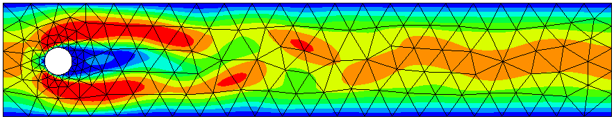

The absolute value of velocity:
../_images/navierstokes_solution.jpg
