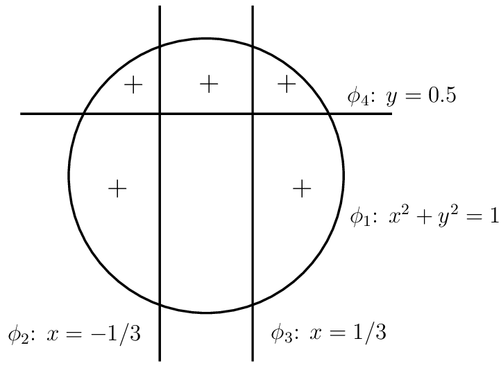

Let us again consider the above case of a Zalesak Disk consisting of the 5 regions, marked with a \(+\): "
geo.AddRectangle((-1.1, -1.1), (1.1, 1.1), bc=1)
mesh = Mesh(geo.GenerateMesh(maxh=0.2/interactive))
level_sets = [x * x + y * y - 1, -x - 1 / 3, x - 1 / 3, y - 0.5]
level_sets_p1 = tuple(GridFunction(H1(mesh, order=1))
                      for i in range(len(level_sets)))
for i, lsetp1 in enumerate(level_sets_p1):
    InterpolateToP1(level_sets[i], lsetp1)
    DrawDC(lsetp1, -3.5, 2.5, mesh, "lset_p1_" + str(i))
The easiest way to generate this is to use the DomainTypeArray functionality:
z_disc =    DomainTypeArray((NEG,ANY,ANY,ANY)) \
         & ~DomainTypeArray((NEG,NEG,NEG,NEG))

However, we note that there are 7 regions, rather than the expected 5. However, on closer inspection, we see that (NEG, POS, POS, POS) and (NEG, POS, POS, NEG) are regions that do not exist with respect to our level sets.
We have two options to remove such irrelevant regions from a DomainTypeArray:

This removes the unnecessary regions (NEG, POS, POS, POS) and (NEG, POS, POS, NEG).
Second:
On initialisation of a DomainTypeArray, we can also pass a tuple lsets of level sets for compression at initilisation, and a flag persistent_compress which indicates, whether the result when using operators schould again be compressed with respect to the same set of level sets
tmp1 = DomainTypeArray((NEG,ANY,ANY,ANY),
                       lsets=level_sets_p1,
                       persistent_compress=True)
tmp2 = DomainTypeArray((NEG,NEG,NEG,NEG),
z_disc2 = tmp1 & ~tmp2
z_disc2.as_list

The difference between persistent_compress=True/False becomes more apparent when computing the boundary.
z_disc = DomainTypeArray((NEG,ANY,ANY,ANY)) & ~DomainTypeArray((NEG,NEG,NEG,NEG))
bnd1 = z_disc.Boundary()
DrawDC(bnd1.IndicatorSmoothed(level_sets_p1,0.08/interactive), -3.5, 2.5, mesh, "bnd1")
bnd1.as_list

Integrating using DomainTypeArrays
In order to use DomainTypeArrays for integration purposes we can simply pass the DomainTypeArray to the domain_type argumet of the SymbolicDifferentialSymbol dCut:
[41]:
area_zd = pi - 2 / 3 * (0.5 + sqrt(2) * 2 / 3)
area_zd += - (2 * asin(1 / 3) - sin(2 * asin(1 / 3))) / 2
area = Integrate(CoefficientFunction(1) * dCut(level_sets_p1, z_disc2, order=0), mesh)
print("Area 2 = {:12.10f}".format(area))
print("Error: {:4.2e}".format(abs(area - area_zd)))
Area 2 = 2.1260431413
Error: 2.81e-02
