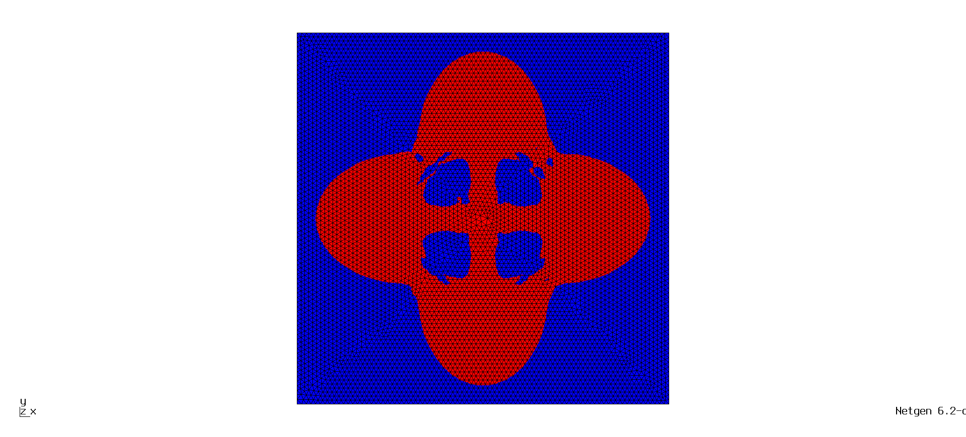

scene = Draw(psi)
scene_cr = Draw(cutRatio, mesh, "cutRatio")
iter_max = 20
converged = False
xm=0.
ym=0.
psi.Set( (x-xm)**2+(y-ym)**2-0.25**2)
psinew.vec.data= psi.vec
J = Integrate(Cost(gfu),mesh)
for k in range(iter_max):
print("================ iteration ", k, "===================")
# copy new levelset data from psinew into psi
psi.vec.data = psinew.vec
SolvePDE(adjoint=True)
J_current = Integrate(Cost(gfu),mesh)
print( Integrate( (gfu-gfud)**2*dx, mesh) )
print("cost in beginning of iteration", k, ": Cost = ", J_current)
# compute the piecewise constant topological derivative in each domain
TDPosNeg_pwc.Set( BetaPosNeg * grad(gfu) * grad(gfp) + FPosNeg*gfp )
TDNegPos_pwc.Set( BetaNegPos * grad(gfu) * grad(gfp) + FPosNeg*gfp )
# compute the cut ratio of the interface elements
InterpolateLevelSetToElems(psi, 1, 0, cutRatio, mesh, EPS)
scene_cr.Redraw()
# compute the combined topological derivative using the cut ratio information
for j in range(len(TD_pwc.vec)):
TD_pwc.vec[j] = cutRatio.vec[j] * TDNegPos_pwc.vec[j] + (1-cutRatio.vec[j])*TDPosNeg_pwc.vec[j]
TD_node.Set(TD_pwc)
normTD = sqrt(Integrate(TD_node**2*dx, mesh)) # L2 norm of TD_node
TD_node.vec.data = 1/normTD * TD_node.vec # normalised TD_node
normPsi = sqrt(Integrate(psi**2*dx, mesh)) # L2 norm of psi
psi.vec.data = 1/normPsi * psi.vec # normalised psi
linesearch = True
for j in range(10):
# update the level set function
psinew.vec.data = (1-kappa)*psi.vec + kappa*TD_node.vec
# update beta and f_rhs
InterpolateLevelSetToElems(psinew, beta1, beta2, beta, mesh, EPS)
InterpolateLevelSetToElems(psinew, f1, f2, f_rhs, mesh, EPS)
# solve PDE without adjoint
SolvePDE()
Redraw(blocking=True)
Jnew = Integrate(Cost(gfu), mesh)
if Jnew > J_current:
print("--------------------")
print("-----line search ---")
kappa = kappa*0.8
print("kappa", kappa)
break
print("----------- Jnew in iteration ", k, " = ", Jnew, " (kappa = ", kappa, ")")
print('')
print("iter" + str(k) + ", Jnew = " + str(Jnew) + " (kappa = ", kappa, ")")
kappa = min(1, kappa*1.2)
print("end of iter " + str(k))
