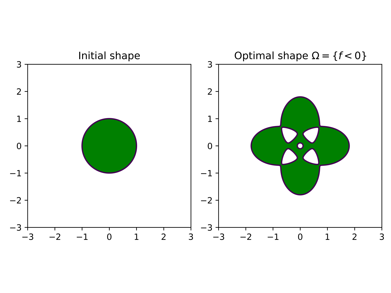

Initial geometry and shape function
We choose \(f\) as
\[\begin{split}\begin{array}{rl} f(x,y) =& \left(\sqrt{(x - a)^2 + b y^2} - 1 \right) \left(\sqrt{(x + a)^2 + b y^2} - 1 \right) \\ & \left(\sqrt{b x^2 + (y - a)^2} - 1 \right) \left(\sqrt{b x^2 + (y + a)^2} - 1 \right) - \varepsilon. \end{array}\end{split}\]
where \(\varepsilon = 0.001, a = 4/5, b = 2\). The corresponding zero level sets of this function are as follows. The green area indicates where \(f\) is negative.

Using SciPy optimize toolbox
We use the package scipy.optimize and wrap the shape functions around it.
We first setup the initial geometry as a circle of radius r = 2.5 (as before)
# The code in this cell is the same as in the example above.
ngsglobals.msg_level = 1
geo.AddCircle((0,0), r = 2.5)
ngmesh = geo.GenerateMesh(maxh = 0.08)
mesh.Curve(2)
# define the function f
a =4.0/5.0
b = 2
f = CoefficientFunction((sqrt((x - a)**2 + b * y**2) - 1) \
                * (sqrt(b * x**2 + (y + a)**2) - 1) - 0.001)
# Now we define the finite element space VEC in which we compute the shape gradient
# element order
order = 1
VEC = H1(mesh, order=order, dim=2)
# define test and trial functions
PHI = VEC.TrialFunction()
PSI = VEC.TestFunction()
# define grid function for deformation of mesh
gfset = GridFunction(VEC)
gfset.Set((0,0))
# only for new gui
#scene = Draw(gfset, mesh, "gfset")
#if scene:
#    scene.setDeformation(True)
# plot the mesh and visualise deformation
#Draw(gfset,mesh,"gfset")
#SetVisualization (deformation=True)
 Curve elements, order = 2
Shape derivative
\[DJ(\Omega)(X) = \int_\Omega f \mbox{div}(X) + \nabla f\cdot X\;dx\]
fX = LinearForm(VEC)
# analytic shape derivative
fX += f*div(PSI)*dx + (f.Diff(x,PSI[0])) *dx + (f.Diff(y,PSI[1])) *dx
Bilinear form for shape gradient
Define the bilinear form
\[(\varphi,\psi) \mapsto b_\Omega(\varphi,\psi):= \int_\Omega (\nabla \varphi+\nabla \varphi^\top): \nabla\psi + \varphi\cdot\psi\; dx\]
to compute the gradient \(X =: \mbox{grad}J\) by
\[b_\Omega(X,\psi) = DJ(\Omega)(\psi)\quad \text{ for all } \psi\in H^1(\Omega)\]
# Cauchy-Riemann descent CR
CR = False
# bilinear form for gradient
aX = BilinearForm(VEC)
aX += InnerProduct(grad(PHI)+grad(PHI).trans, grad(PSI))*dx + InnerProduct(PHI,PSI)*dx
## Cauchy-Riemann regularisation
if CR == True:
    gamma = 100
    aX += gamma * (PHI.Deriv()[0,0] - PHI.Deriv()[1,1])*(PSI.Deriv()[0,0] - PSI.Deriv()[1,1]) *dx
    aX += gamma * (PHI.Deriv()[1,0] + PHI.Deriv()[0,1])*(PSI.Deriv()[1,0] + PSI.Deriv()[0,1]) *dx
aX.Assemble()
invaX = aX.mat.Inverse(VEC.FreeDofs(), inverse="sparsecholesky")
gfX = GridFunction(VEC)
Wrapping the shape function and its gradient
Now we define the shape function \(J\) and its gradient grad(J) use the shape derivative \(DJ\). The arguments of \(J\) and grad(J) are vector in \(\mathbf{R}^d\), where \(d\) is the dimension of the finite element space.
def J(x_):
    gfset.Set((0,0))
    # x_ NumPy vector
    gfset.vec.FV().NumPy()[:] += x_
    mesh.SetDeformation(gfset)
    cost_c = Integrate (f, mesh)
    mesh.UnsetDeformation()
    Redraw(blocking=True)
    return cost_c
def gradJ(x_, euclid = False):
    gfset.Set((0,0))
    # x_ NumPy vector
    fX.Assemble()
    if euclid == True:
        gfX.vec.data = fX.vec
        gfX.vec.data = invaX * fX.vec
    return gfX.vec.FV().NumPy().copy()
Gradient descent and Armijo rule
We use the functions \(J\) and grad J to define a steepest descent method.We use scipy.optimize.line_search_armijo to compute the step size in each iteration. The Arjmijo rule reads
\[J((\mbox{Id}+\alpha_k X_k)(\Omega_k)) \le J(\Omega_k) - c_1 \alpha_k \|\nabla J(\Omega_k)\|^2,\]
where \(c_1:= 1e-4\) and \(\alpha_k\) is the step size.
# import scipy linesearch method
from scipy.optimize.linesearch import line_search_armijo
def gradient_descent(x0, J_, gradJ_):
    xk_ = np.copy(x0)
    # maximal iteration
    it_max = 50
    # count number of function evals
    nfval_total = 0
    print('\n')
    for i in range(1, it_max):
        # Compute a step size using a line_search to satisfy the Wolf
        # compute shape gradient grad J
        grad_xk = gradJ_(xk_,euclid = False)
        # compute descent direction
        pk = -gradJ_(xk_)
        # eval cost function
        fold = J_(xk_)
        # perform armijo stepsize
        if CR == True:
            alpha0 = 0.15
            alpha0 = 0.11
        step, nfval, b = line_search_armijo(J_, xk_, pk = pk, gfk = grad_xk, old_fval = fold, c1=1e-4, alpha0 = alpha0)
        nfval_total += nfval
        # update the shape and print cost and gradient norm
        xk_ = xk_ - step * grad_xk
        print('Iteration ', i, '| Cost ', fold, '| grad norm', np.linalg.norm(grad_xk))
        if np.linalg.norm(gradJ_(xk_)) < 1e-4:
            #print('#######################################')
            print('\n'+'{:<20}  {:<12} '.format("##################################", ""))
            print('{:<20}  {:<12} '.format("### success - accuracy reached ###", ""))
            print('{:<20}  {:<12} '.format("##################################", ""))
            print('{:<20}  {:<12} '.format("gradient norm: ", np.linalg.norm(gradJ_(xk_))))
            print('{:<20}  {:<12} '.format("n evals f: ", nfval_total))
            print('{:<20}  {:<12} '.format("f val: ", fold) + '\n')
            break
        elif i == it_max-1:
            #print('######################################')
            print('\n'+'{:<20}  {:<12} '.format("#######################", ""))
            print('{:<20}  {:<12} '.format("### maxiter reached ###", ""))
            print('{:<20}  {:<12} '.format("#######################", ""))
/tmp/ipykernel_132299/197104950.py:2: DeprecationWarning: Please use `line_search_armijo` from the `scipy.optimize` namespace, the `scipy.optimize.linesearch` namespace is deprecated.
Now we are ready to run our first optimisation algorithm:
gfset.vec[:]=0
x0 = gfset.vec.FV().NumPy() # initial guess = 0
gradient_descent(x0, J, gradJ)
Iteration  1 | Cost  63.58544060454411 | grad norm 441.5929065866198
Iteration  2 | Cost  -0.7382545763570351 | grad norm 4.7952700977043685
Iteration  3 | Cost  -0.7857727667400566 | grad norm 4.810253357263983
Iteration  4 | Cost  -0.8340100892582087 | grad norm 4.778142295070986
Iteration  5 | Cost  -0.8819829476436056 | grad norm 4.690302282301046
Iteration  6 | Cost  -0.9285214898272736 | grad norm 4.539798263167342
Iteration  7 | Cost  -0.9723556895806401 | grad norm 4.3229768578625265
Iteration  8 | Cost  -1.0122531578877725 | grad norm 4.04105181526849
Iteration  9 | Cost  -1.0471883778786093 | grad norm 3.701224549853242
Iteration  10 | Cost  -1.076504443665547 | grad norm 3.3168858328915642
Iteration  11 | Cost  -1.1000162626592398 | grad norm 2.9062027551569325
Iteration  12 | Cost  -1.1180150904153732 | grad norm 2.4897881641333455
Iteration  13 | Cost  -1.1311719155347586 | grad norm 2.087580497013262
Iteration  14 | Cost  -1.1403746530625036 | grad norm 1.7159371235340435
Iteration  15 | Cost  -1.1465562098318822 | grad norm 1.385718678918207
Iteration  16 | Cost  -1.1505622552842771 | grad norm 1.1024720780232578
Iteration  17 | Cost  -1.1530807674166712 | grad norm 0.8664390301856703
Iteration  18 | Cost  -1.154625445865094 | grad norm 0.6744733131571219
Iteration  19 | Cost  -1.1555550744962926 | grad norm 0.5214023587336312
Iteration  20 | Cost  -1.1561072737628182 | grad norm 0.4012572471223365
Iteration  21 | Cost  -1.1564329926583787 | grad norm 0.3081264784784448
Iteration  22 | Cost  -1.1566250729528902 | grad norm 0.23664608420808184
Iteration  23 | Cost  -1.156739221824035 | grad norm 0.18221681468365367
Iteration  24 | Cost  -1.1568082482769877 | grad norm 0.14104424517287645
Iteration  25 | Cost  -1.156851212982562 | grad norm 0.11008000257674344
Iteration  26 | Cost  -1.1568790835671514 | grad norm 0.08691942912250206
Iteration  27 | Cost  -1.156898134112397 | grad norm 0.06968543512602478
Iteration  28 | Cost  -1.1569119439709799 | grad norm 0.05692156240844278
Iteration  29 | Cost  -1.1569225568515866 | grad norm 0.04750014325185836
Iteration  30 | Cost  -1.156931146061588 | grad norm 0.04055031381078992
Iteration  31 | Cost  -1.1569383917279348 | grad norm 0.035404371147589625
Iteration  32 | Cost  -1.1569446953786267 | grad norm 0.03155781707996529
Iteration  33 | Cost  -1.1569502999928782 | grad norm 0.02863749771929034
Iteration  34 | Cost  -1.1569553580085303 | grad norm 0.02637399371759421
Iteration  35 | Cost  -1.1569599695029114 | grad norm 0.02457708618313277
Iteration  36 | Cost  -1.1569642036044872 | grad norm 0.02311474669624737
Iteration  37 | Cost  -1.1569681109470848 | grad norm 0.021896245450960156
Iteration  38 | Cost  -1.1569717306087155 | grad norm 0.020859390544323616
Iteration  39 | Cost  -1.1569750939270342 | grad norm 0.019961362418991904
Iteration  40 | Cost  -1.1569782269881668 | grad norm 0.019172877193450746
Iteration  41 | Cost  -1.1569811514952684 | grad norm 0.018471912284186234
Iteration  42 | Cost  -1.156983887154983 | grad norm 0.01784541316540462
Iteration  43 | Cost  -1.1569864496512077 | grad norm 0.017278988193844186
Iteration  44 | Cost  -1.1569888554425787 | grad norm 0.016765650640741692
Iteration  45 | Cost  -1.1569911182298955 | grad norm 0.01629879591809301
Iteration  46 | Cost  -1.1569932500627187 | grad norm 0.015873146903417953
Iteration  47 | Cost  -1.1569952619910004 | grad norm 0.01548516589730978
Iteration  48 | Cost  -1.1569971633976466 | grad norm 0.015129700903154325
Iteration  49 | Cost  -1.1569989636230704 | grad norm 0.01480437146262251
gradient norm:        0.014506461247564089
n evals f:            49
f val:                -1.1569989636230704
