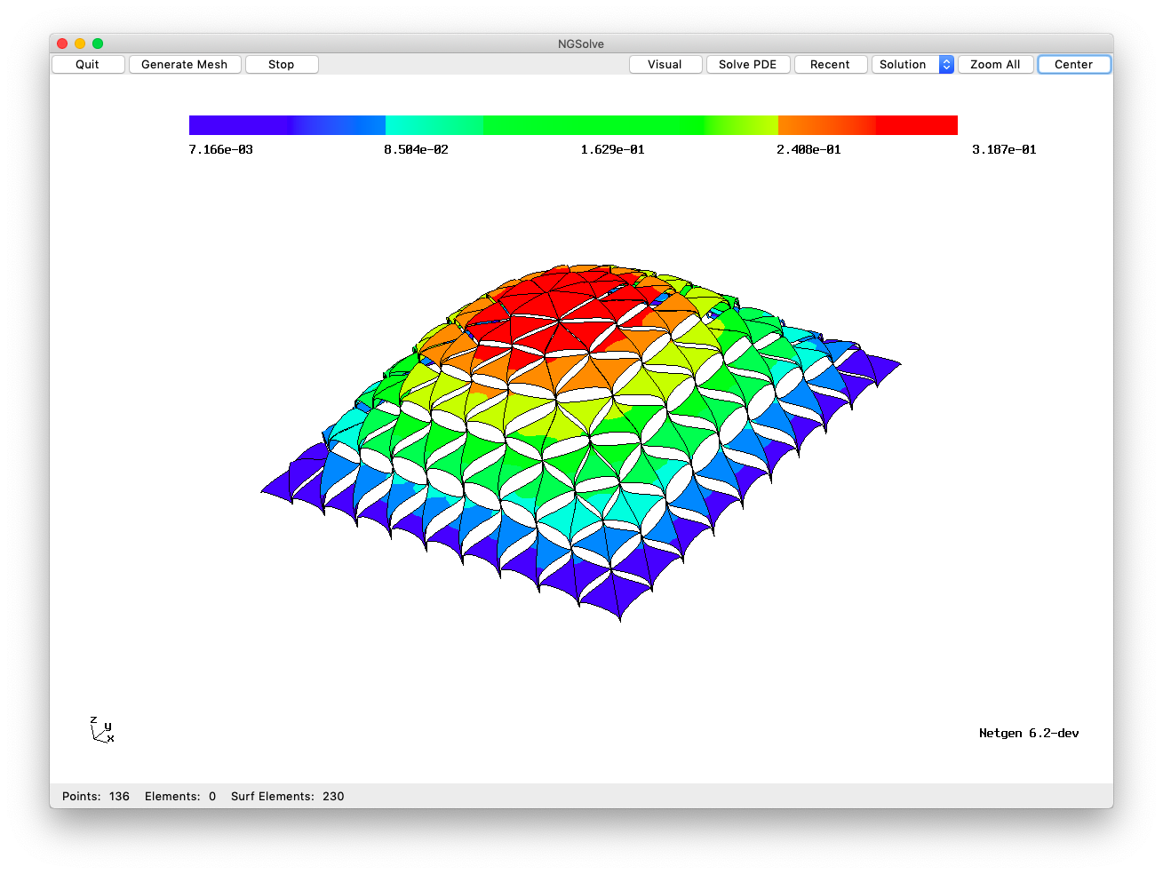

For the BDDC (balancing domain decomposition with constraints) preconditioning, we build a FEM system with relaxed connectivity:
596c23ea85da4bd29adf0437ab431e56
This allows for static condensation of all local and interface degrees of freedom, only the wirebasket dofs enter the global solver. The resulting matrix \(\tilde A\) is much cheaper to invert.
The preconditioner is
\[P = R {\tilde A}^{-1} R^T\]
with an averagingn operator \(R\).

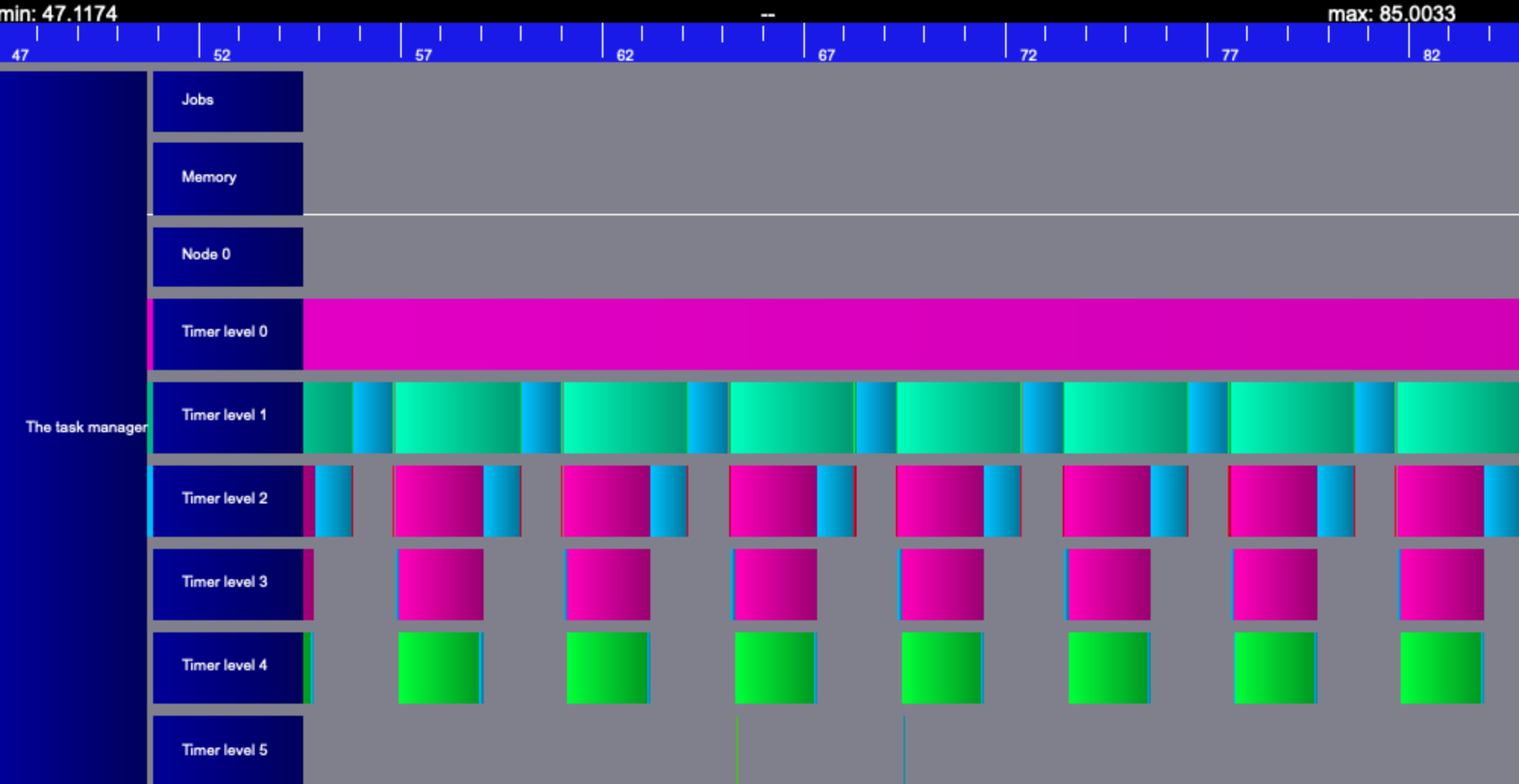

Vite - traces:
31fd651400f84174886f786a21a9f033
