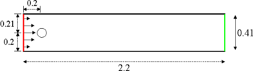

Again, we consider the benchmark setup from http://www.featflow.de/en/benchmarks/cfdbenchmarking/flow/dfg_benchmark2_re100.html . The geometry:
../../_images/geometry.png
The viscosity is set to \(\nu = 10^{-3}\).

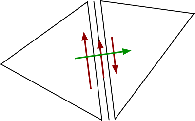

For the HDG formulation we use the product space with
  • \(BDM_k\): \(H(div)\) conforming FE space (degree k)
  • Vector facet space: facet functions of degree k (vector valued and only in tangential direction)
  • piecewise polynomials up to degree \(k-1\) for the pressure
../../_images/stokeshdghdiv.png
HDG spaces
