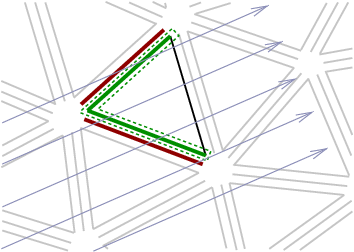

Convection formulation (Hybrid Upwinding):¶
\[ \sum_T \int_T - u \mathbf{w} \cdot \nabla v
+ \sum_T \int_{\partial T} (\mathbf{w} \cdot \mathbf{n}) u^{hyb-upw} v
+ \sum_T \int_{\partial T_{out}} (\mathbf{w} \cdot \mathbf{n}) (\hat{u} - u) \hat{v}\]
\[\begin{split}u^{hyb-upw} = \left\{ \begin{array}{cll} u & \text{if } \mathbf{w} \cdot \mathbf{n} & (outflow), \\ \hat{u} & \text{else} & (inflow) . \end{array} \right.\end{split}\]
outflow |
inflow |
