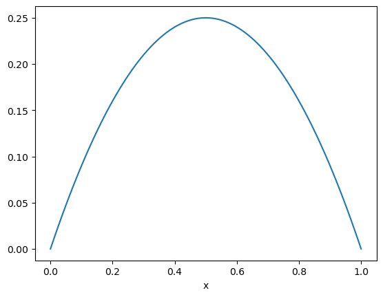

We may plot the restriction of the CoefficientFunction
on a line using matplotlib.
X = np.linspace(0, 1, num=100)
Y = np.ones_like(X) * 0.2
plt.plot(X, myfunc(mesh(X, Y)))
plt.xlabel('x')
