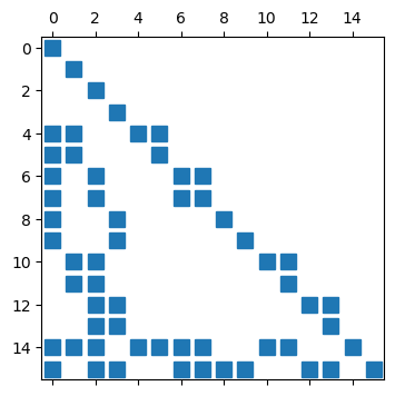

The vertex degrees of freedom vanish for edge and element basis functions, and the edge degrees of freedom vanish for element basis functions, but not vice-versa. Thus, the obtained matrix A is block-triangular:
import scipy.sparse as sp
A = sp.csr_matrix(a.mat.CSR())
plt.rcParams['figure.figsize'] = (4,4)
plt.spy(A)
We can use proper block Gauss-Seidel smoothing for solving with that block triangular matrix by blocking the dofs for the individual vertices, edges and elements. Since the NGSolve Gauss-Seidel smoother reorders the order of smoothing blocks for parallelization, we have to take care to first compute vertex values, then edge values, and finally element values by running three different Gauss-Seidel sweeps.
