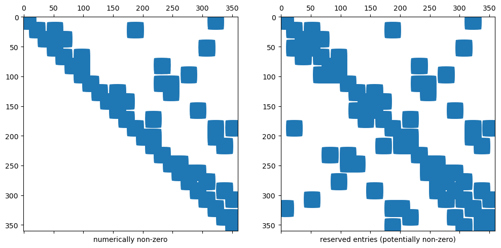

Remarks on sparsity pattern in NGSolve
Remark 1: The sparsity pattern is set up a-priorily
  • The sparsity pattern of a sparse matrix in NGSolve is independent of its entries (it’s set up a-priorily).
  • We can have "nonzero" entries that have the value 0
Below we show the reserved memory for the sparse matrix and the (numerically) non-zero entries in this sparse matrix.
fes2 = L2(mesh, order=order, dgjumps=True)
u,v=fes2.TnT()
a3 = BilinearForm(fes2)
a3 += u*v*dx + (u+u.Other())*v*dx(skeleton=True)
a3.Assemble();
import scipy.sparse as sp
import matplotlib.pylab as plt
plt.rcParams['figure.figsize'] = (12, 12)
A = sp.csr_matrix(a3.mat.CSR())
fig = plt.figure(); ax1 = fig.add_subplot(121); ax2 = fig.add_subplot(122)
ax1.set_xlabel("numerically non-zero"); ax1.spy(A)
ax2.set_xlabel("reserved entries (potentially non-zero)"); ax2.spy(A,precision=-1)
../../_images/i-tutorials_unit-2.8-DG_DG_29_0.png

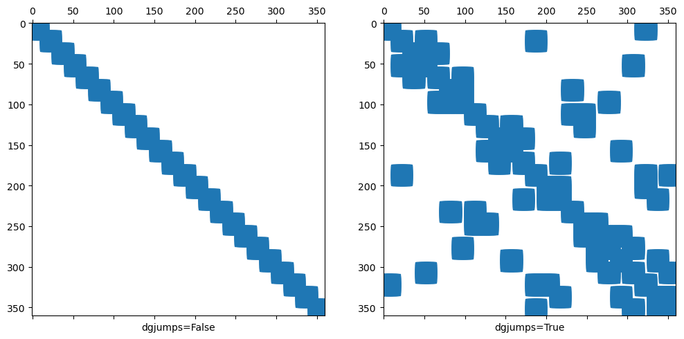

Remark 2: Sparsity pattern with and without dgjumps=True is different
(can’t create sp.csr_matrix after latest unused entries optimization)
# a1 = BilinearForm(L2(mesh, order=order, dgjumps=False)); a1.Assemble()
# a2 = BilinearForm(L2(mesh, order=order, dgjumps=True)); a2.Assemble()
# A1 = sp.csr_matrix(a1.mat.CSR())
# A2 = sp.csr_matrix(a2.mat.CSR())
# fig = plt.figure(); ax1 = fig.add_subplot(121); ax2 = fig.add_subplot(122)
# ax1.set_xlabel("dgjumps=False"); ax1.spy(A1,precision=-1)
# ax2.set_xlabel("dgjumps=True"); ax2.spy(A2,precision=-1)
# plt.show()

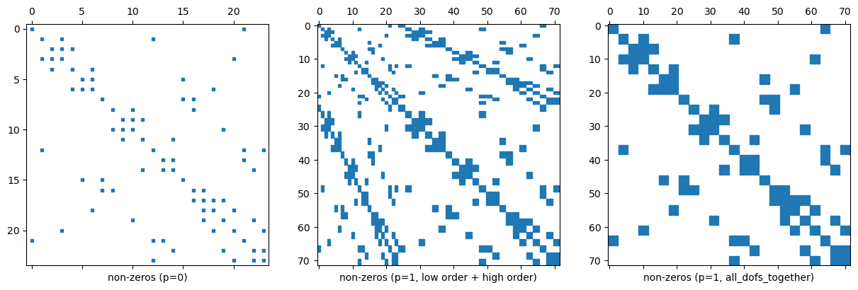

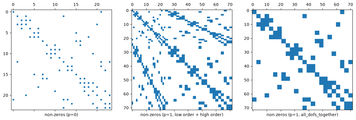

Remark 3: Dof numbering of higher order FESpaces
  • In NGSolve FESpaces typically have a numbering where the first block of dofs corresponds to a low order subspace (which is convenient for iterative solvers).
  • For L2 this means that the first dofs correspond to the constants on elements.
  • You can turn this behavior off for some spaces, e.g. for L2 by adding the flag all_dofs_together.
We demonstrate this in the next comparison:
plt.rcParams['figure.figsize'] = (15, 15)
fig = plt.figure()
ax = [fig.add_subplot(131), fig.add_subplot(132), fig.add_subplot(133)]
for i, (order, all_dofs_together, label) in enumerate([(0,False, "non-zeros (p=0)"),
                                                    (1,False,"non-zeros (p=1, low order + high order)"),
                                                    (1,True,"non-zeros (p=1, all_dofs_together)")]):
    a = BilinearForm(L2(mesh,order=order,dgjumps=True,all_dofs_together=all_dofs_together))
    ax[i].spy(sp.csr_matrix(a.mat.CSR()),markersize=3,precision=-1)
    ax[i].set_xlabel(label)
../../_images/i-tutorials_unit-2.8-DG_DG_34_0.png
