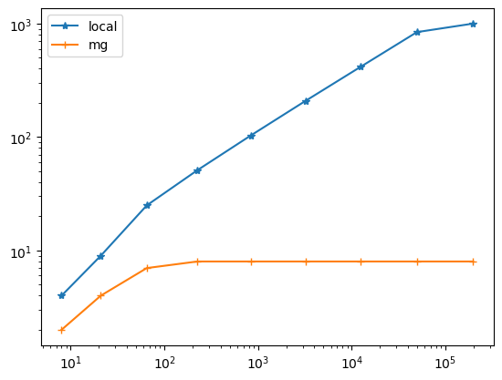

Multigrid preconditioner
A geometric multigrid Preconditioner uses the sequence of refined meshes to define a preconditioner yielding optimal iteration numbers (and complexity). It uses a direct solve on the coarsest level, and block Gauss-Seidel smoothers on the refined levels.
res_mg = SolveProblem(levels=9, precond="multigrid")
res_mg
WARNING: 'maxsteps' is deprecated, use maxiter instead!
[(8, 2),
 (21, 5),
 (65, 9),
 (225, 11),
 (833, 12),
 (3201, 12),
 (12545, 12),
 (49665, 12),
 (197633, 12)]
plt.xscale("log")
plt.yscale("log")
plt.plot(*zip(*res_local), "-*")
plt.plot(*zip(*res_mg), "-+")
plt.legend(['local', 'mg'])
../../_images/i-tutorials_unit-2.1.1-preconditioners_preconditioner_10_0.png

p= 1 : ndof,nsteps= [(8, 2), (21, 2), (65, 2), (225, 2)]
p= 2 : ndof,nsteps= [(21, 7), (65, 14), (225, 23), (833, 25)]
p= 3 : ndof,nsteps= [(40, 12), (133, 19), (481, 29), (1825, 32)]
p= 4 : ndof,nsteps= [(65, 15), (225, 23), (833, 33), (3201, 37)]
p= 5 : ndof,nsteps= [(96, 17), (341, 26), (1281, 38), (4961, 42)]
p= 6 : ndof,nsteps= [(133, 19), (481, 28), (1825, 40), (7105, 45)]
p= 7 : ndof,nsteps= [(176, 20), (645, 31), (2465, 43), (9633, 48)]
p= 8 : ndof,nsteps= [(225, 21), (833, 33), (3201, 46), (12545, 51)]
p= 9 : ndof,nsteps= [(280, 22), (1045, 34), (4033, 47), (15841, 54)]
The BDDC preconditioner needs more iterations, but the work per iteration is less, so performance is similar to multigrid. This element-wise BDDC preconditioner works well in shared memory parallel as well as in distributed memory mode. See \(\S\)2.1.4 for more about BDDC preconditioner and how to combine it with an algebraic multigrid coarse solver.
