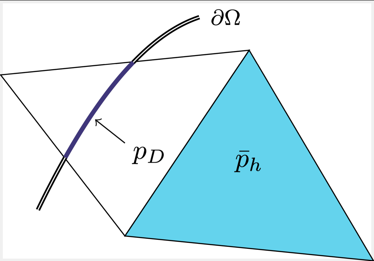

The first effect can be cured when applying a ghost penalty stabilization which ensures a smooth extension of the discrete solution onto the whole active mesh.
The second effect comes from the inconsistency that we introduced when changing the integration domain from \(\Omega\) to the active mesh. The latter problem can be cured by reconstructing a better, consistent approximation of \(p\) based on good interior values and a good approximation of \(u\) by postprocessing, which we discuss next.
Patchwise Post-processing
In the following post-processing we exploit that \(u\) is (optimally) accurate on \(\Omega\) (independent of GP choice) and that \(p\) is accurate in the interior. We then apply standard post-processing strategies on uncut elements and use an adapted patch-wise version for cut elements.
On each patch \(\omega\) with subtriangulation \(\mathcal{T}_\omega\), we want to find \(p_h^\ast \in \mathbb{P}^{k+1}(\mathcal{T}_\omega)\) so that \begin{align} (\nabla p_h^\ast, \nabla q_h^\ast)_{\Omega \cap \omega} + j_h^\omega(p_h^\ast,q_h^\ast) &= (u_h,\nabla q_h^\ast)_{\Omega \cap \omega} \qquad \forall q_h^\ast \in \mathbb{P}^{k+1}(\mathcal{T}_\omega) \setminus \mathbb{R} \tag{P1-local} \\ (p_h^\ast,1)_{\omega \cap \Omega^{\text{int}}} &= (\bar p_h,1)_{\omega \cap \Omega^{\text{int}}}. \tag{P2-local} \end{align} Here \(j_h^{\omega}(\cdot,\cdot)\) is a patch-local ghost penalty with an \(H^1\) (instead of \(L^2\)) scaling.
We can reformulate this as a global problem on the whole mesh, especially the integral constraint, with the help of a Lagrange multiplier \(\lambda \in \mathbb{P}^0(\mathcal{T}_h^{\text{int}})\): Find \(p_h^s \in \mathbb{P}^{k+1}(\mathcal{T}_h)\) and \(\lambda \in \mathbb{P}^0(\mathcal{T}_h^{\text{int}})\) so that \begin{align} (\nabla p_h^\ast, \nabla q_h^\ast)_{\Omega} + j_h^\omega(p_h^\ast,q_h^\ast) + (q_h^\ast,\lambda)_{\mathcal{T}_h^{\text{int}}} &= (u_h,\nabla q_h^\ast)_{\Omega} \qquad \forall q_h^\ast \in \mathbb{P}^{k+1}(\mathcal{T}_h) \tag{P1} \\ (p_h^\ast,\mu)_{\mathcal{T}_h^{\text{int}}} &= (p_h^\ast,\mu)_{\mathcal{T}_h^{\text{int}}} \qquad \forall \mu \in \mathbb{P}^0(\mathcal{T}_h^{\text{int}}). \tag{P2} \end{align}
Let’s start with the corresponding definition of the spaces (and corresponding trial/test functions and a solution GridFunction):
#FE Spaces for el-wise post-processing

Then, we setup the formulation \((P1)\)-\((P2)\):
#Integration domain for ghost penalty
dP = dFacetPatch(definedonelements=EA.patch_interior_facets, deformation=deformation)
lhs_integrals = [grad(ps) * grad(vs) * dX,
                 (lam * vs + mu * ps) * dxinner,
                 1/h**2 * (ps - ps.Other()) * (vs - vs.Other()) * dP]
rhs_integrals = [gfu * grad(vs) * dX,
                 gfpT * mu * dxinner]
