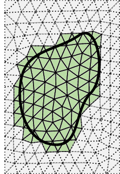

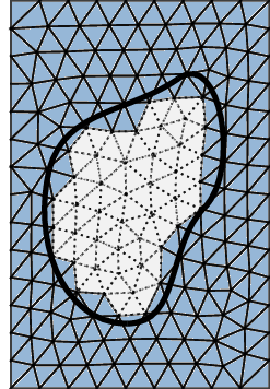

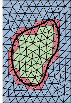

Cut FE spaces
For the discretization we use standard background FESpaces restricted to the subdomains:
\[V_h^\Gamma \quad = \qquad V_h |_{\Omega_-^{lin}} \quad \oplus \quad V_h |_{\Omega_+^{lin}}\]
composed
inner
outer
spaceboth
spaceinner
spaceouter
In NGSolve we simply take the product space \(V_h \times V_h\) but mark the irrelevant dofs using the CutInfo-class:

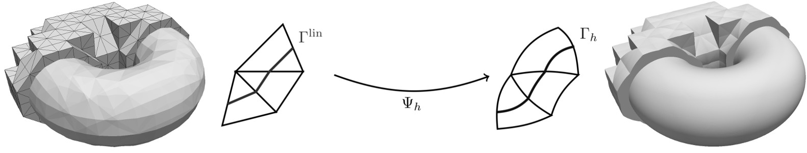

Higher order accuracy
In the previous example we used a second order FESpace but only used a second order accurate geometry representation (due to \(\phi_h^{lin}\)).
We can improve this by applying a mesh transformation technique, cf. intlset.ipynb:
lsetcurv
# for isoparametric mapping
lsetmeshadap = LevelSetMeshAdaptation(mesh, order=2)
Draw(deformation, mesh, "deformation")
# alternatively to passing the deformation to dCut me can do the mesh deformation by hand
mesh.deformation = deformation
mesh.deformation = None
SolveLinearSystem()
DrawDC(lsetp1, gfu.components[0], gfu.components[1], mesh, "u", deformation=deformation, min=0, max=0.25)
uh = IfPos(lsetp1, gfu.components[1], gfu.components[0])
deform_graph = CoefficientFunction((deformation[0], deformation[1], 4*uh))
DrawDC(lsetp1, gfu.components[0], gfu.components[1], mesh, "graph_of_u", deformation=deform_graph, min=0, max=0.25)
XFEM spaces
Instead of the CutFEM space
\[V_h^\Gamma = V_h |_{\Omega_-^{lin}} \oplus V_h |_{\Omega_+^{lin}}\]
we can use the (same) space with an XFEM characterization:
\[V_h^\Gamma = V_h \oplus V_h^x\]
with the space \(V_h^x\) which adds the necessary enrichments.
In ngsxfem we can also work with this XFEM spaces:
Vh = H1(mesh, order=2, dirichlet=[1,2,3,4])
Vhx = XFESpace(Vh,ci)
VhG = FESpace([Vh,Vhx])
original
after cut
xfem1
xfem2
  • The space Vhx copies all shape functions from Vh on cut (IF) elements (and stores a sign (NEG/POS))
  • The sign determines on which domain the shape function should be supported (and where not)
  • Advantage: every dof is an active dof (i.e. no dummy dofs)
  • Need to express \(u_+\) and \(u_-\) in terms of \(u_h^{std}\) and \(u_h^x\):
    • \(u_- = u_h^{std} +\) neg(\(u_h^x\)) and \(u_+ = u_h^{std} +\) pos(\(u_h^x\))
  • neg and pos filter out the right shape functions of Vhx
