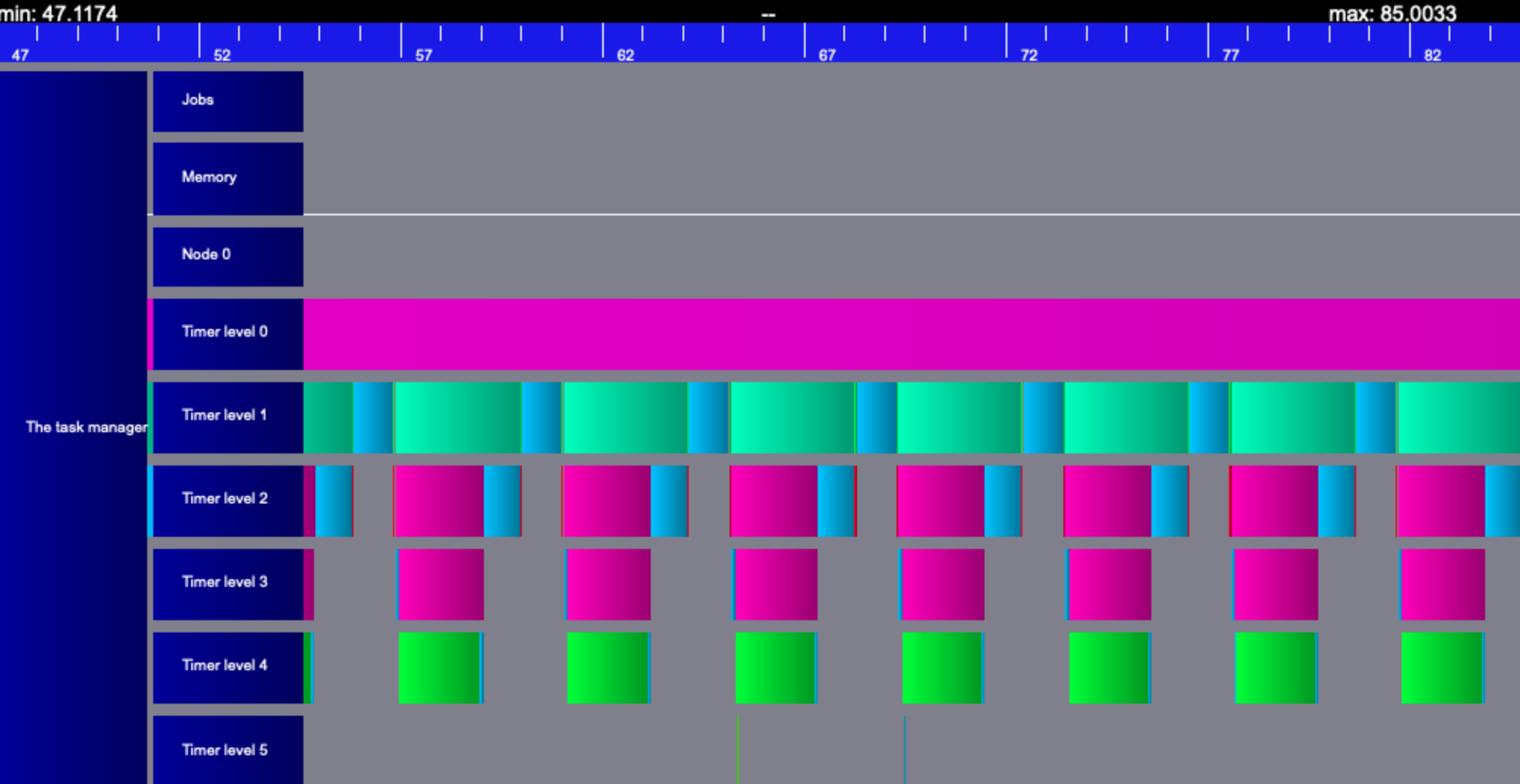

Vite - traces:
1e89562a988741a09340c6446a0663b1
