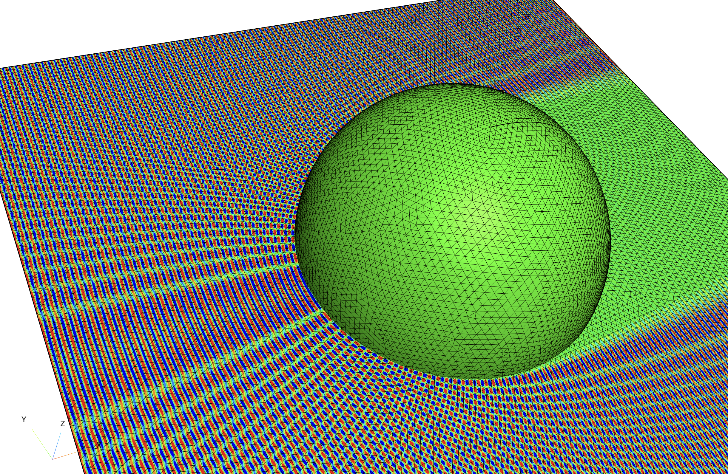

Scattering from sphere with \(D = 50 \lambda\). About 1h on Macbook Apple M4 Pro
