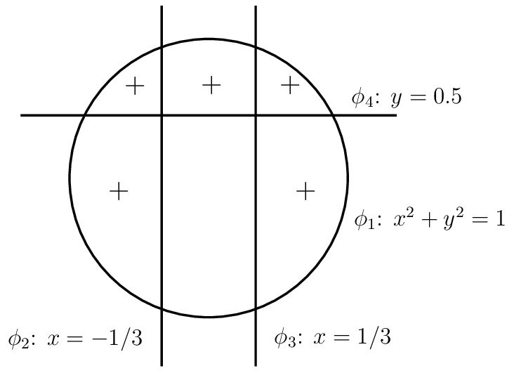

Let us again consider the above case of a Zalesak Disk consisting of the 5 regions, marked with a \(+\): "
geo.AddRectangle((-1.1, -1.1), (1.1, 1.1), bc=1)
mesh = Mesh(geo.GenerateMesh(maxh=0.2/interactive))
level_sets = [x * x + y * y - 1, -x - 1 / 3, x - 1 / 3, y - 0.5]
level_sets_p1 = tuple(GridFunction(H1(mesh, order=1))
for i in range(len(level_sets)))
for i, lsetp1 in enumerate(level_sets_p1):
InterpolateToP1(level_sets[i], lsetp1)
DrawDC(lsetp1, -3.5, 2.5, mesh, "lset_p1_" + str(i))
The easiest way to generate this is to use the DomainTypeArray
functionality:
z_disc = DomainTypeArray((NEG,ANY,ANY,ANY)) \
& ~DomainTypeArray((NEG,NEG,NEG,NEG))
z_disc.as_list
[(<DOMAIN_TYPE.NEG: 0>,
<DOMAIN_TYPE.POS: 1>),
<DOMAIN_TYPE.POS: 1>,
<DOMAIN_TYPE.NEG: 0>),
<DOMAIN_TYPE.POS: 1>)]
DrawDC(z_disc.Indicator(level_sets_p1), -3.5, 2.5, mesh, "zdisc")
However, we note that there are 7 regions, rather than the expected 5. However, on closer inspection, we see that (NEG, POS, POS, POS)
and (NEG, POS, POS, NEG)
are regions that do not exist with respect to our level sets.
We have two options to remove such irrelevant regions from a DomainTypeArray
First:

This removes the unnecessary regions (NEG, POS, POS, POS)
