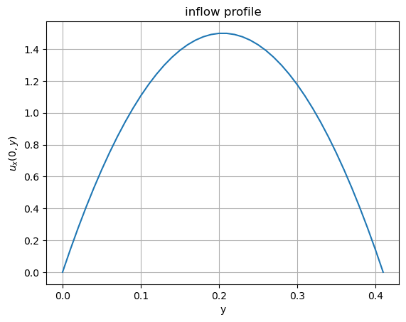

inflow profile plot:
import matplotlib; import numpy as np; import matplotlib.pyplot as plt;
%matplotlib inline
s = np.arange(0.0, 0.42, 0.01)
bvs = 6*s*(0.41-s)/(0.41)**2
plt.plot(s, bvs)
plt.xlabel('y'); plt.ylabel('$u_x(0,y)$'); plt.title('inflow profile')
plt.grid(True)
../../_images/i-tutorials_unit-3.2-navierstokes_navierstokes_12_0.png

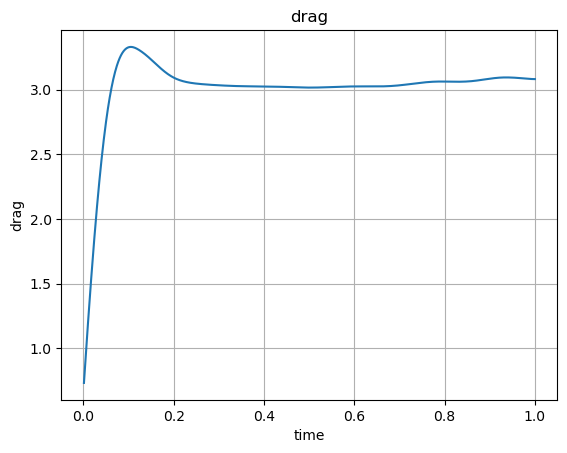

Below you can plot the gathered drag and lift values:
# Plot drag force over time
plt.plot(time_vals, drag_x_vals)
plt.xlabel('time'); plt.ylabel('drag'); plt.title('drag'); plt.grid(True)
../../_images/i-tutorials_unit-3.2-navierstokes_navierstokes_38_0.png

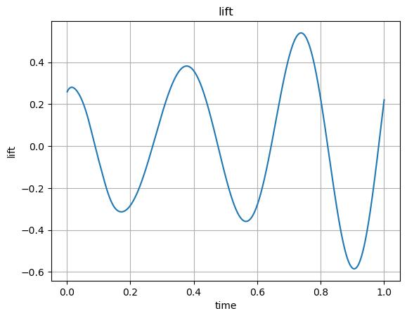

# Plot lift force over time
plt.plot(time_vals, drag_y_vals)
plt.xlabel('time'); plt.ylabel('lift'); plt.title('lift'); plt.grid(True)
../../_images/i-tutorials_unit-3.2-navierstokes_navierstokes_39_0.png
