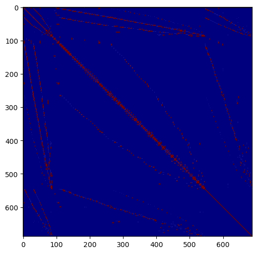

First, we create a matrix of same format as m.mat and compare number of non-zero entries and sparsity pattern:
print(f"m.mat.nze = {m.mat.nze}, a.mat.nze={a.mat.nze}, mstar.nze={mstar.nze}")
from helper import ShowPattern
print("sparsity pattern a.mat:")
ShowPattern(a.mat,binarize=True)
m.mat.nze = 11104, a.mat.nze=11104, mstar.nze=11104
print("sparsity pattern mstar:")
ShowPattern(mstar,binarize=True)
