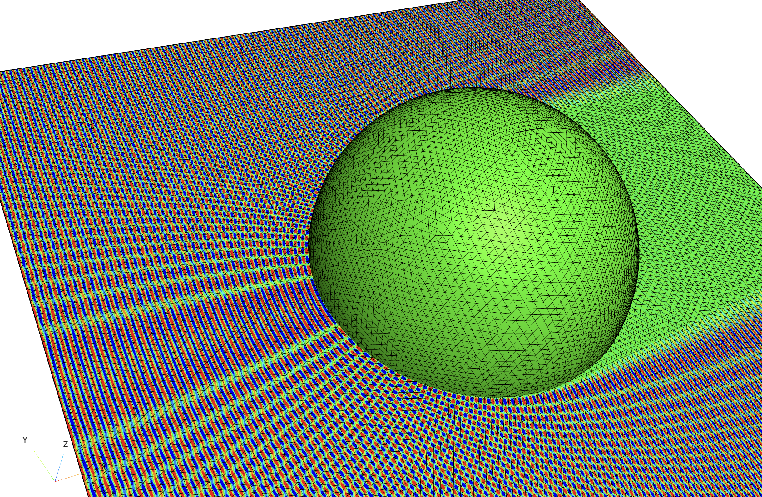

print ("Scattered field")
Draw (uscat, mesh, min=-1,max=1, animate_complex=True, order=4);
Scattered field
uin = mesh.BoundaryCF( {"screen": source }, default=0)
print ("Total field")
Draw (uin-uscat, mesh, min=-1,max=1, animate_complex=True, order=4);
Total field
Scattering from sphere with \(D = 50 \lambda\). About 1h on Macbook Apple M4 Pro
