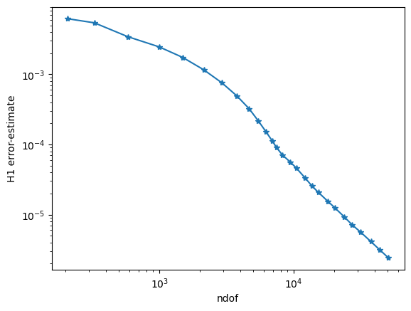

Gradient recovery error estimator: Interpolate finite element flux
\[q_h := I_h (\lambda \nabla u_h)\]
and take difference as element error indicator:
\[\eta_T := \tfrac{1}{\lambda} \| q_h - \lambda \nabla u_h \|_{L_2(T)}^2\]
l = [] # l = list of estimated total error
space_flux = HDiv(mesh, order=2, autoupdate=True)
gf_flux = GridFunction(space_flux, "flux", autoupdate=True)
def CalcError():
# FEM-flux
flux = lam * grad(gfu)
# interpolate into H(div)
gf_flux.Set(flux)
# compute estimator:
err = 1/lam*(flux-gf_flux)*(flux-gf_flux)
eta2 = Integrate(err, mesh, VOL, element_wise=True)
l.append ((fes.ndof, sqrt(sum(eta2))))
print("ndof =", fes.ndof, " toterr =", sqrt(sum(eta2)))
# mark for refinement:
maxerr = max(eta2)
# marking with Python loop:
# for el in mesh.Elements():
# mesh.SetRefinementFlag(el, eta2[el.nr] > 0.25*maxerr)
# marking using numpy:
mesh.ngmesh.Elements2D().NumPy()["refine"] = \
eta2.NumPy() > 0.25*maxerr
CalcError()

Adaptive loop:
level = 0
while fes.ndof < 50000:
SolveBVP()
CalcError()
level = level+1
if level%5 == 0:
Draw (gfu)
ndof = 328 toterr = 0.005424419894719641
ndof = 583 toterr = 0.0034370983010913294
ndof = 997 toterr = 0.0024617055250623224
ndof = 1492 toterr = 0.0017417208970402825
ndof = 2143 toterr = 0.001159036769265472
ndof = 2917 toterr = 0.0007578273431000435
ndof = 3775 toterr = 0.000493096916783832
ndof = 4651 toterr = 0.0003247245805364616
ndof = 5440 toterr = 0.00021839607818093112
ndof = 6211 toterr = 0.00015253103584489278
ndof = 6910 toterr = 0.00011329794969631048
ndof = 7456 toterr = 9.041817442322814e-05
ndof = 8263 toterr = 7.05016031884768e-05
ndof = 9433 toterr = 5.622462330206224e-05
ndof = 10495 toterr = 4.587268141504037e-05
ndof = 12130 toterr = 3.351750230659081e-05
ndof = 13675 toterr = 2.564899368696983e-05
ndof = 15259 toterr = 2.077431963572974e-05
ndof = 18055 toterr = 1.5345303474890484e-05
ndof = 20347 toterr = 1.2390591822142242e-05
ndof = 23761 toterr = 9.324033982234093e-06
ndof = 27262 toterr = 7.144658685394859e-06
ndof = 31426 toterr = 5.654098735383225e-06
ndof = 37588 toterr = 4.121876481044875e-06
ndof = 43645 toterr = 3.159814850590886e-06
ndof = 50794 toterr = 2.4145846823594603e-06
Draw (gfu);
%matplotlib inline
plt.yscale('log')
plt.xscale('log')
plt.xlabel("ndof")
plt.ylabel("H1 error-estimate")
ndof,err = zip(*l)
plt.plot(ndof,err, "-*")
plt.ion()
plt.show();
