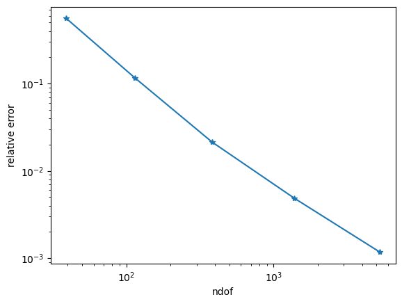

Direct approach where shear locking may occur
Adding interpolation (reduction) operator \(\boldsymbol{R}:[H^1_0(\Omega)]^2\to H(\text{curl})\). Spaces are chosen according to [Brezzi, Fortin and Stenberg. Error analysis of mixed-interpolated elements for Reissner-Mindlin plates. Mathematical Models and Methods in Applied Sciences 1, 2 (1991), 125-151.]
Gamma = HCurl(mesh,order=order,orderedge=order-1, autoupdate=True)
a += t**3/12*(2*mu*InnerProduct(Sym(grad(beta)),Sym(grad(dbeta))) + lam*div(beta)*div(dbeta))*dx
#a += t*k*G*InnerProduct( grad(u)-beta, grad(du)-dbeta )*dx
a += t*k*G*InnerProduct(Interpolate(grad(u)-beta,Gamma), Interpolate(grad(du)-dbeta,Gamma))*dx
f += -fz*du*dx
gfsol = GridFunction(fes, autoupdate=True)
gfbeta, gfu = gfsol.components
WARNING: kwarg 'orderedge' is an undocumented flags option for class <class 'ngsolve.comp.HCurl'>, maybe there is a typo?
Define function for solving the problem.
def SolveBVP():
fes.Update()
gfsol.Update()
inv = a.mat.Inverse(fes.FreeDofs(), inverse="sparsecholesky")
gfsol.vec.data = inv * f.vec
Solve, compute error, refine, …
l = []
for i in range(5):
print("i = ", i)
SolveBVP()
if clamped:
norm_w = sqrt(Integrate(w_c_ex*w_c_ex, mesh))
err = sqrt(Integrate((gfu-w_c_ex)*(gfu-w_c_ex), mesh))/norm_w
norm_w = sqrt(Integrate(w_s_ex*w_s_ex, mesh))
err = sqrt(Integrate((gfu-w_s_ex)*(gfu-w_s_ex), mesh))/norm_w
print("err = ", err)
l.append ( (fes.ndof, err ))
i = 0
err = 0.5595598334579744
i = 1
err = 0.11654484017074333
i = 2
err = 0.021448789397901354
i = 3
err = 0.004856535560194802
i = 4
err = 0.0011748158819470667
Convergence plot with matplotlib.
plt.yscale('log')
plt.xscale('log')
plt.xlabel("ndof")
plt.ylabel("relative error")
ndof,err = zip(*l)
plt.plot(ndof,err, "-*")
plt.ion()

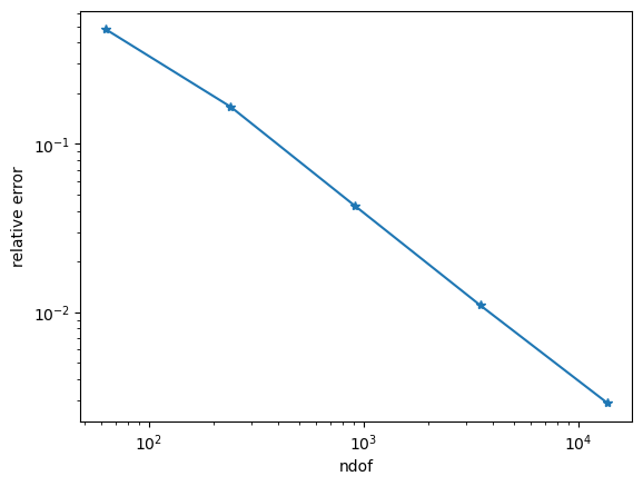

TDNNS method¶
Invert material law of Hooke and reset mesh.
def CMatInv(mat, E, nu):
return (1+nu)/E*(mat-nu/(nu+1)*Trace(mat)*Id(2))
mesh = Mesh(sg.GenerateMesh(maxh=R/3))
mesh.Curve(order)
Instead of using Lagrangian elements together with an interpolation operator we can directly use H(curl) for the rotation \(\beta\).
order=1
if clamped:
fesB = HCurl(mesh, order=order-1, dirichlet="circ", autoupdate=True)
fesS = HDivDiv(mesh, order=order-1, dirichlet="", autoupdate=True)
fesB = HCurl(mesh, order=order-1)
fesS = HDivDiv(mesh, order=order-1, dirichlet="circ", autoupdate=True)
fesW = H1(mesh, order=order, dirichlet="circ", autoupdate=True)
fes = FESpace( [fesW, fesB, fesS], autoupdate=True )
(u,beta,sigma), (du,dbeta,dsigma) = fes.TnT()
Use the TDNNS method with the stress (bending) tensor \(\boldsymbol{\sigma}\) as proposed in [Pechstein and Schöberl. The TDNNS method for Reissner-Mindlin plates. Numerische Mathematik 137, 3 (2017), 713-740] \begin{align*} &\mathcal{L}(u,\beta,\boldsymbol{\sigma})=-\frac{6}{t^3}\|\boldsymbol{\sigma}\|^2_{\mathcal{C}^{-1}} + \langle \boldsymbol{\sigma}, \nabla \beta\rangle + \frac{tkG}{2}\|\nabla u-\beta\|^2 -\int_{\Omega} f\cdot u\,dx\\ &\langle \boldsymbol{\sigma}, \nabla \beta\rangle:= \sum_{T\in\mathcal{T}}\int_T\boldsymbol{\sigma}:\nabla \beta\,dx -\int_{\partial T}\boldsymbol{\sigma}_{nn}\beta_n\,ds \end{align*}
a += (-12/t**3*InnerProduct(CMatInv(sigma, E, nu),dsigma) + InnerProduct(dsigma,grad(beta)) + InnerProduct(sigma,grad(dbeta)))*dx
a += ( -((sigma*n)*n)*(dbeta*n) - ((dsigma*n)*n)*(beta*n) )*dx(element_boundary=True)
f += -fz*du*dx
gfu, gfbeta, gfsigma = gfsol.components
def SolveBVP():
fes.Update()
gfsol.Update()
inv = a.mat.Inverse(fes.FreeDofs())
Solve, compute error, and refine.
l = []
for i in range(5):
print("i = ", i)
SolveBVP()
if clamped:
i = 0
err = 0.48069152680627136
i = 1
err = 0.16608403907856958
i = 2
err = 0.04302102328044192
i = 3
err = 0.011002228688264282
i = 4
err = 0.0028879335128787504
plt.yscale('log')
plt.xscale('log')
plt.xlabel("ndof")
ndof,err = zip(*l)
plt.ion()
