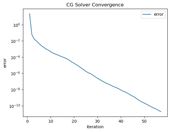

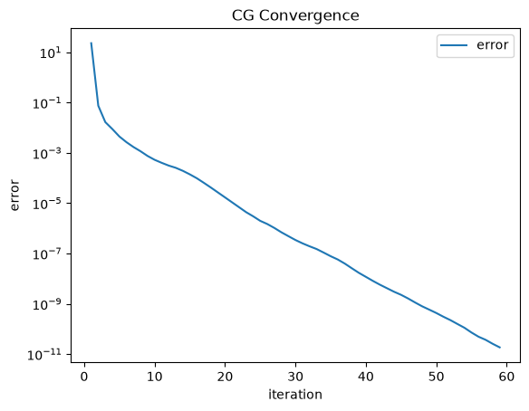

inv = CGSolver(a.mat, pre, printrates=True)
CG iteration 1, residual = 22.868681780028357
CG iteration 2, residual = 0.060240433819207684
CG iteration 3, residual = 0.01688138730372943
CG iteration 4, residual = 0.009401866596848626
CG iteration 5, residual = 0.0047438048834076854
CG iteration 6, residual = 0.0025977528209947657
CG iteration 7, residual = 0.001608134542781628
CG iteration 8, residual = 0.001026538997791458
CG iteration 9, residual = 0.0007114919914743376
CG iteration 10, residual = 0.00045676914310471465
CG iteration 11, residual = 0.0003154967505407483
CG iteration 12, residual = 0.0002347008178782672
CG iteration 13, residual = 0.00018038057874759879
CG iteration 14, residual = 0.00013676076747261537
CG iteration 15, residual = 0.00010324082534623955
CG iteration 16, residual = 8.079870023045407e-05
CG iteration 17, residual = 5.9217637822027655e-05
CG iteration 18, residual = 3.9611833346813144e-05
CG iteration 19, residual = 2.508128136315508e-05
CG iteration 20, residual = 1.7193421358400776e-05
CG iteration 21, residual = 1.1362820264770306e-05
CG iteration 22, residual = 7.368029844695135e-06
CG iteration 23, residual = 4.580740725764851e-06
CG iteration 24, residual = 2.8499829717233606e-06
CG iteration 25, residual = 1.7574036567355723e-06
CG iteration 26, residual = 1.1706048726196645e-06
CG iteration 27, residual = 9.139592967710672e-07
CG iteration 28, residual = 5.902757429012982e-07
CG iteration 29, residual = 3.701393973948329e-07
CG iteration 30, residual = 2.3773288510410232e-07
CG iteration 31, residual = 1.597448124927387e-07
CG iteration 32, residual = 1.0764268481229778e-07
CG iteration 33, residual = 7.355018729893283e-08
CG iteration 34, residual = 5.5134013465565926e-08
CG iteration 35, residual = 4.073548973581209e-08
CG iteration 36, residual = 2.8807633482898947e-08
CG iteration 37, residual = 2.1288485110655945e-08
CG iteration 38, residual = 1.6414244964757658e-08
CG iteration 39, residual = 1.2293718222313219e-08
CG iteration 40, residual = 8.382925314549433e-09
CG iteration 41, residual = 5.770606918957002e-09
CG iteration 42, residual = 4.3939272223445855e-09
CG iteration 43, residual = 3.162179719833387e-09
CG iteration 44, residual = 2.095419761193874e-09
CG iteration 45, residual = 1.462361220111827e-09
CG iteration 46, residual = 1.041014633619494e-09
CG iteration 47, residual = 6.450267981035144e-10
CG iteration 48, residual = 4.1422686349618406e-10
CG iteration 49, residual = 2.7934656570272687e-10
CG iteration 50, residual = 2.0430335665987403e-10
CG iteration 51, residual = 1.5137071087440875e-10
CG iteration 52, residual = 1.0193928666647424e-10
CG iteration 53, residual = 7.099497588460725e-11
CG iteration 54, residual = 4.8051333741341604e-11
CG iteration 55, residual = 3.446820423396461e-11
CG iteration 56, residual = 2.7575541142664517e-11
CG iteration 57, residual = 2.011846143472482e-11
