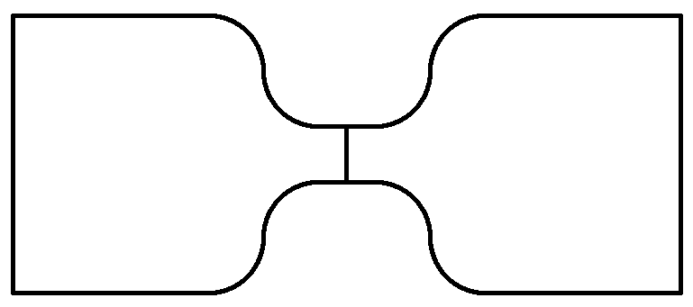

The dam break problem (geometry)
geomsketch
# geometry description (including boundary/mat names)
wp = WorkPlane()
wp.MoveTo(-12,-5).LineTo(-3,-5).NameVertex("fillet")
wp.LineTo(-3,-1).NameVertex("fillet")
wp.LineTo(0,-1).LineTo(0,0).LineTo(-12,0).Close()
geo = wp.Face()
geo = geo.MakeFillet(list(set(geo.vertices["fillet"])),2)
geo = geo + geo.Mirror(Axis((0,0,0),X)).Reversed()
geo = Glue([geo,geo.Mirror(Axis((0,0,0),Y)).Reversed()])
geo.faces.Min(X).name="upperlevel"
geo.faces.Max(X).name="lowerlevel"
geo.edges.name = "wall"
geo.edges.Nearest((0,0)).name = "dam"
#Draw(geo)
geo = OCCGeometry(geo,dim=2)
mesh = Mesh(geo.GenerateMesh(maxh=2))
mesh.Curve(3)
