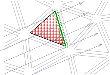

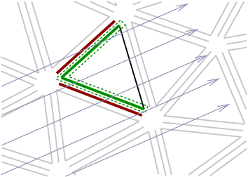

Convection formulation (Hybrid Upwinding):
\[ \sum_T \int_T - u \mathbf{w} \cdot \nabla v + \sum_T \int_{\partial T} (\mathbf{w} \cdot \mathbf{n}) u^{hyb-upw} v + \sum_T \int_{\partial T_{out}} (\mathbf{w} \cdot \mathbf{n}) (\hat{u} - u) \hat{v}\]
\[\begin{split}u^{hyb-upw} = \left\{ \begin{array}{cll} u & \text{if } \mathbf{w} \cdot \mathbf{n} & (outflow), \\ \hat{u} & \text{else} & (inflow) . \end{array} \right.\end{split}\]
outflow
inflow
elementupwind
facetupwind
# convection (surface version of Egger+Schöberl formulation):
a += - u * InnerProduct(b,gradv) * ds
a += IfPos(bn, bn*u, bn*uE) * v * dr + IfPos(bn, bn, 0) * (uE - u) * vE * dr
