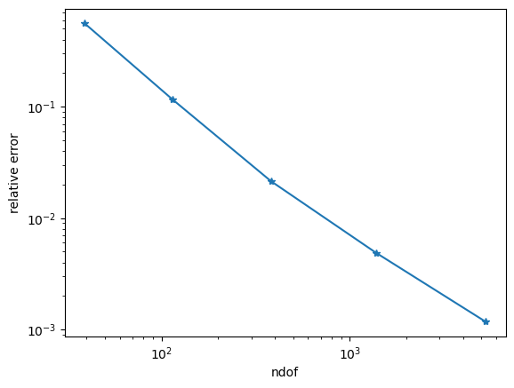

l = []
for i in range(5):
    print("i = ", i)
    SolveBVP()
    if clamped:
        norm_w = sqrt(Integrate(w_c_ex*w_c_ex, mesh))
        err = sqrt(Integrate((gfu-w_c_ex)*(gfu-w_c_ex), mesh))/norm_w
        norm_w = sqrt(Integrate(w_s_ex*w_s_ex, mesh))
        err = sqrt(Integrate((gfu-w_s_ex)*(gfu-w_s_ex), mesh))/norm_w
    print("err = ", err)
    l.append ( (fes.ndof, err ))
i =  0
err =  0.5595598334579744
i =  1
err =  0.11654484017089844
i =  2
err =  0.02144878939829964
i =  3
err =  0.004856535559094238
i =  4
err =  0.0011748158832957027
Convergence plot with matplotlib.
plt.yscale('log')
plt.xscale('log')
plt.xlabel("ndof")
plt.ylabel("relative error")
ndof,err = zip(*l)
plt.plot(ndof,err, "-*")
plt.ion()
../../_images/i-tutorials_unit-6.1.3-rmplate_Reissner_Mindlin_plate_19_0.png

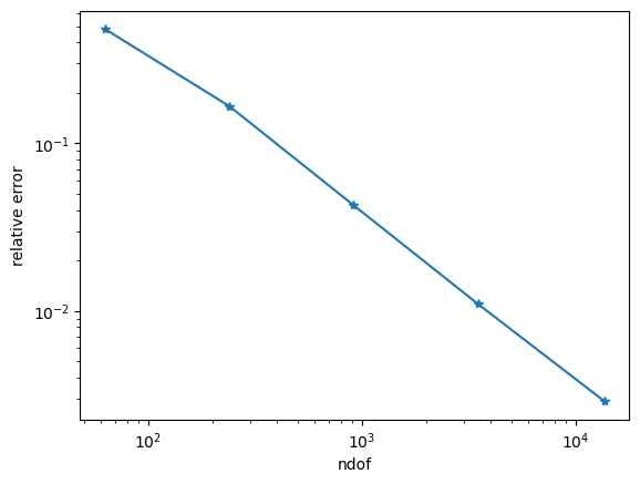

l = []
for i in range(5):
    print("i = ", i)
    SolveBVP()
    if clamped:
i =  0
err =  0.48069152680627136
i =  1
err =  0.16608403907856958
i =  2
err =  0.04302102328044192
i =  3
err =  0.011002228688264282
i =  4
err =  0.0028879335128787504
plt.yscale('log')
plt.xscale('log')
plt.xlabel("ndof")
ndof,err = zip(*l)
plt.ion()
../../_images/i-tutorials_unit-6.1.3-rmplate_Reissner_Mindlin_plate_31_0.png
