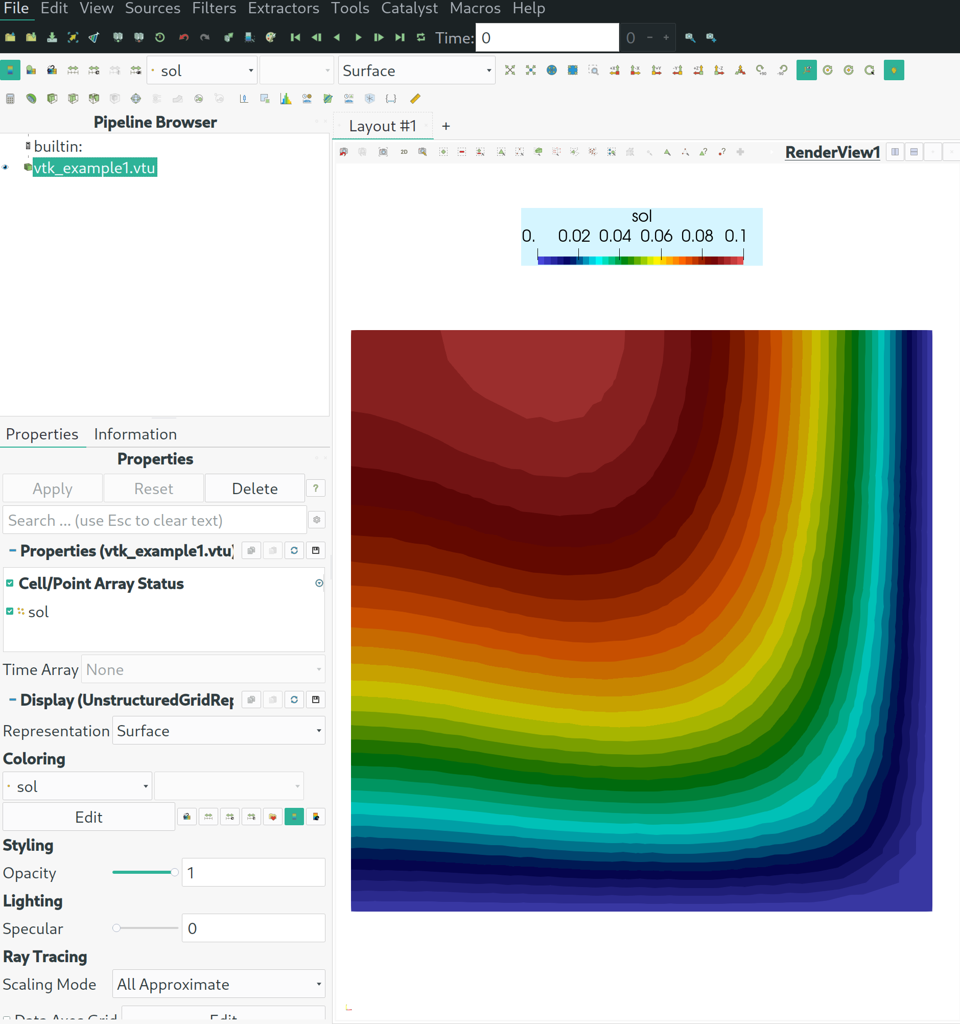

Now, instead of using the webgui, let us export the result data to a vtk file:
vtk = VTKOutput(mesh,coefs=[gfu],names=["sol"],filename="vtk_example1",subdivision=2)
vtk.Do()
'vtk_example1'
Note, only the Do()-call writes the output. Let’s see what we got:
!ls -lh vtk_example1*
-rw-rw-r-- 1 root root 303K Sep  8 11:39 vtk_example1.png
-rw-r--r-- 1 root root  36K Sep  8 11:44 vtk_example1.vtu
We obtained the file vtk_example1.vtu. This file can be opened with ParaView, e.g. with paraview vtk_example1.vtu where you can select your solution field and use several "filters" to process the data to get nice visualizations as the following:

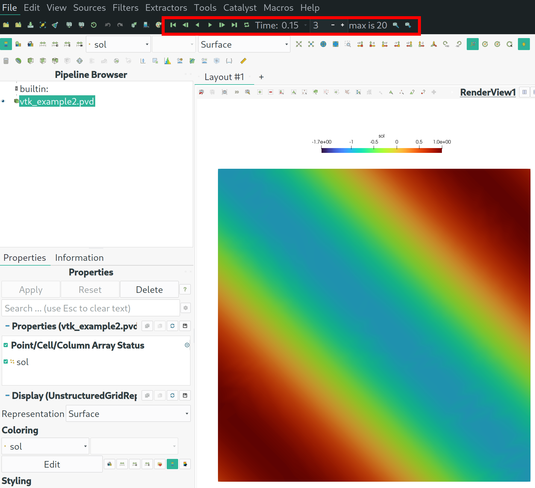

In some cases you may want to analyse a sequence of simulation, e.g. for generating a video. In this case, you simply call Do() several times. You can also provide an additional time stamp with e.g. Do(time=0.3).
Let’s take a time-dependent coefficient function and put this to a sequence of VTK outputs:
t = Parameter(0)
coef = sin(4*(x+y+t))
vtkout = VTKOutput(mesh,coefs=[coef],names=["sol"],filename="vtk_example2",subdivision=2)
vtkout.Do(time = 0.0)
for i in range(20):
    t.Set((i+1)/20)
    vtkout.Do(time = (i+1)/20.0)

  • We obtained 21 .vtu-files corresponding to the 21 Do-calls.
  • Only the first Do-call does not have an additional suffix, while later calls append the _step...-suffix.
  • Furthermore there is a .pvd file which bundles the individual files and associates them to the provided time stamps (if provided):

Now you can open this "meta file" with paraview and visualize the time series with many different filter. Finally, you can export stills or videos from that. It will look like this:
