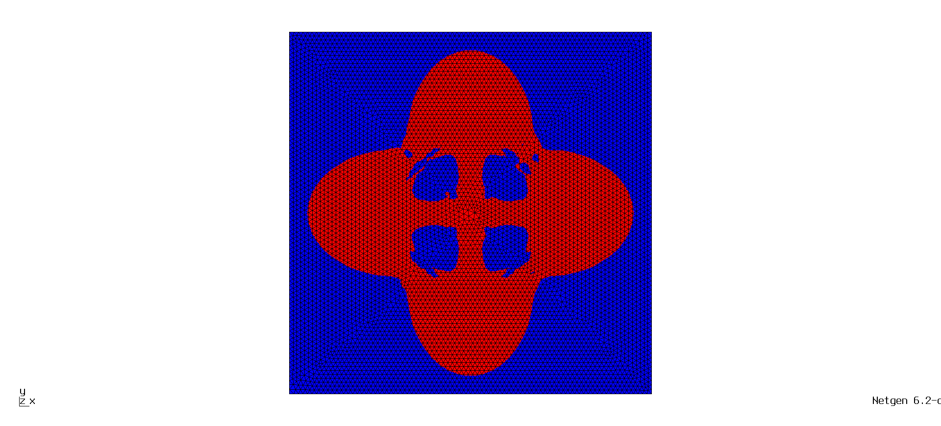

scene = Draw(psi)
scene_cr = Draw(cutRatio, mesh, "cutRatio")

    for k in range(iter_max):
        print("================ iteration ", k, "===================")
        # copy new levelset data from psinew into psi
        psi.vec.data = psinew.vec
        SolvePDE(adjoint=True)
        J_current = Integrate(Cost(gfu),mesh)
        print( Integrate( (gfu-gfud)**2*dx, mesh) )
        print("cost in beginning of iteration", k, ": Cost = ", J_current)
        # compute the piecewise constant topological derivative in each domain
        TDPosNeg_pwc.Set( BetaPosNeg * grad(gfu) * grad(gfp)  + FPosNeg*gfp )
        TDNegPos_pwc.Set( BetaNegPos * grad(gfu) * grad(gfp)  + FPosNeg*gfp )
        # compute the cut ratio of the interface elements
        InterpolateLevelSetToElems(psi, 1, 0, cutRatio, mesh, EPS)
        scene_cr.Redraw()
        # compute the combined topological derivative using the cut ratio information
        for j in range(len(TD_pwc.vec)):
            TD_pwc.vec[j] = cutRatio.vec[j] * TDNegPos_pwc.vec[j] + (1-cutRatio.vec[j])*TDPosNeg_pwc.vec[j]
        TD_node.Set(TD_pwc)
        normTD = sqrt(Integrate(TD_node**2*dx, mesh)) # L2 norm of TD_node
        TD_node.vec.data = 1/normTD * TD_node.vec # normalised TD_node
        normPsi = sqrt(Integrate(psi**2*dx, mesh)) # L2 norm of psi
        psi.vec.data = 1/normPsi * psi.vec  # normalised psi
        linesearch = True
        for j in range(10):
            # update the level set function
            psinew.vec.data = (1-kappa)*psi.vec + kappa*TD_node.vec
            # update beta and f_rhs
            InterpolateLevelSetToElems(psinew, beta1, beta2, beta, mesh, EPS)
            InterpolateLevelSetToElems(psinew, f1, f2, f_rhs, mesh, EPS)
            # solve PDE without adjoint
            SolvePDE()
            Redraw(blocking=True)
            Jnew = Integrate(Cost(gfu), mesh)
            if Jnew > J_current:
                print("--------------------")
                print("-----line search ---")
                kappa = kappa*0.8
                print("kappa", kappa)
                break
        print("----------- Jnew in  iteration ", k, " = ", Jnew, " (kappa = ", kappa, ")")
        print('')
        print("iter" + str(k) + ", Jnew = " + str(Jnew) + " (kappa = ", kappa, ")")
        kappa = min(1, kappa*1.2)
        print("end of iter " + str(k))
