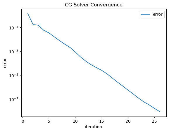

    inv = solvers.CGSolver(a.mat, pre.mat, tol=1e-8, maxiter=100, plotrates=True)
    gfu.vec.data = inv*f.vec
../../_images/i-tutorials_unit-2.1.5-amg_amg_18_0.png
