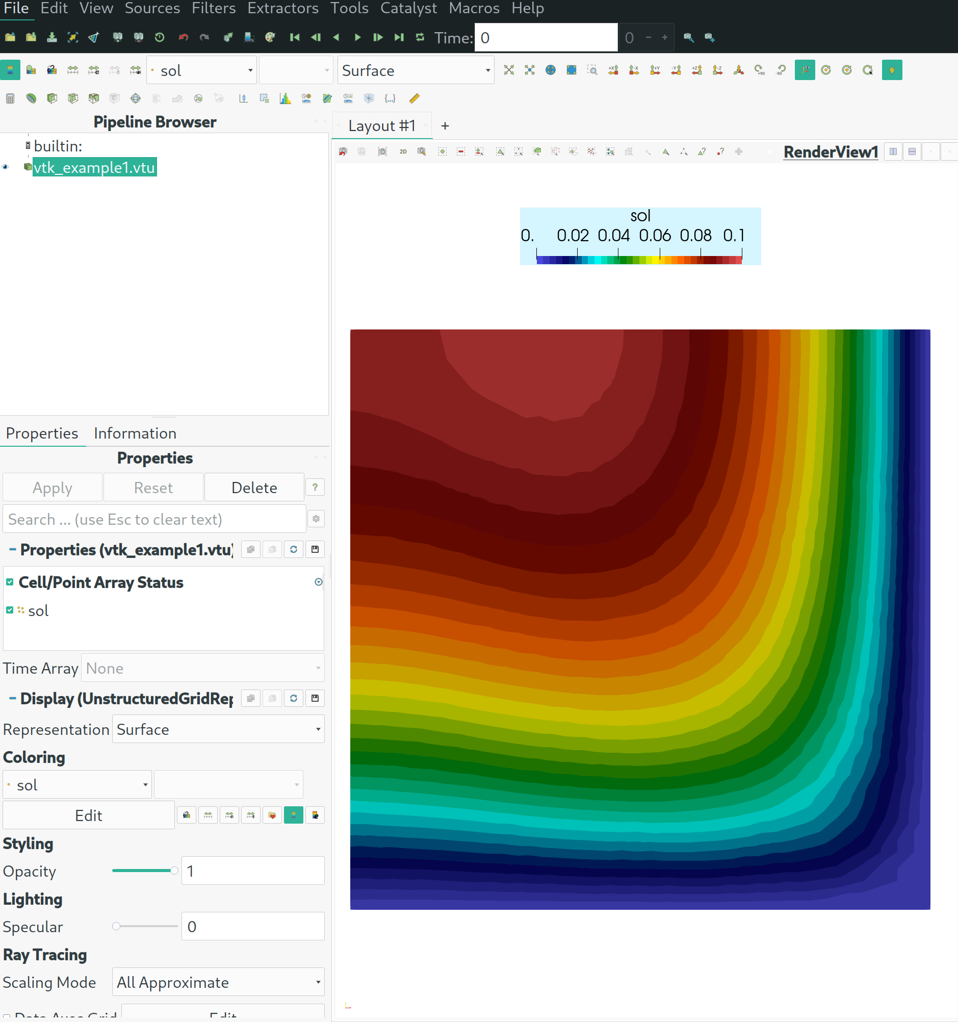

Now, instead of using the webgui, let us export the result data to a vtk file:
vtk = VTKOutput(mesh,coefs=[gfu],names=["sol"],filename="vtk_example1",subdivision=2)
vtk.Do()

Note, only the Do()
-call writes the output. Let’s see what we got:
!ls -lh vtk_example1*
-rw-rw-r-- 1 root root 303K Jul 11 17:07 vtk_example1.png
-rw-r--r-- 1 root root 36K Jul 11 17:11 vtk_example1.vtu
We obtained the file vtk_example1.vtu
. This file can be opened with ParaView, e.g. with paraview vtk_example1.vtu
where you can select your solution field and use several "filters" to process the data to get nice visualizations as the following:
You can now play around with tools like paraview to do many different complex operations.

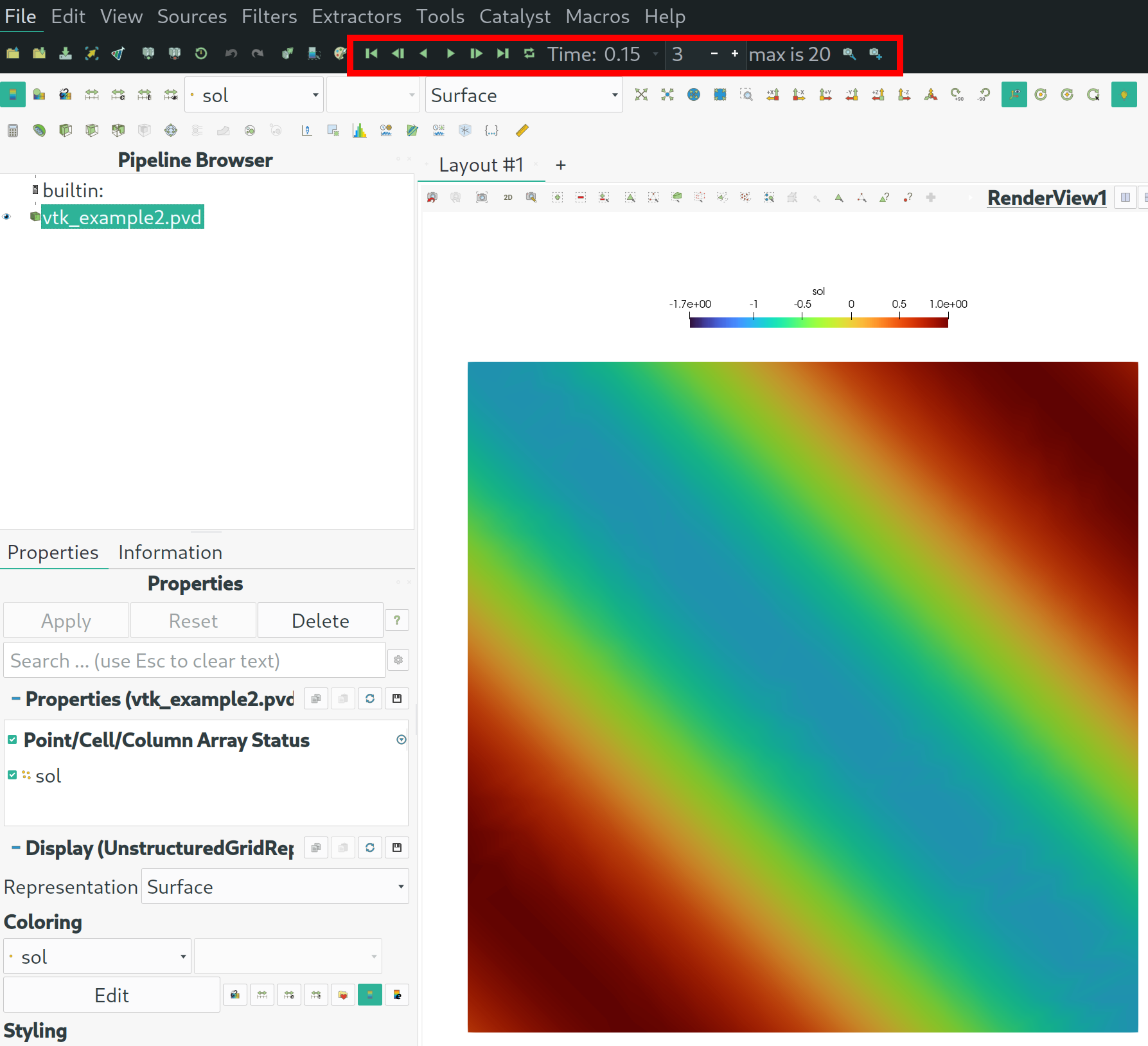

Example 2: Series of data¶
In some cases you may want to analyse a sequence of simulation, e.g. for generating a video. In this case, you simply call Do()
several times. You can also provide an additional time stamp with e.g. Do(time=0.3)

Let’s see what we got this time:
ls -lh vtk_example2*
-rw-rw-r-- 1 root root 350K Jul 11 17:07 vtk_example2.png
-rw-r--r-- 1 root root 1.4K Jul 11 17:11 vtk_example2.pvd
-rw-r--r-- 1 root root 36K Jul 11 17:11 vtk_example2.vtu
-rw-r--r-- 1 root root 36K Jul 11 17:11 vtk_example2_step00001.vtu

We obtained 21
.vtu
-files corresponding to the 21Do
-calls.Only the first
Do
-call does not have an additional suffix, while later calls append the_step...
-suffix.Furthermore there is a
.pvd
file which bundles the individual files and associates them to the provided time stamps (if provided):
!cat vtk_example2.pvd

Now you can open this "meta file" with paraview and visualize the time series with many different filter. Finally, you can export stills or videos from that. It will look like this:
