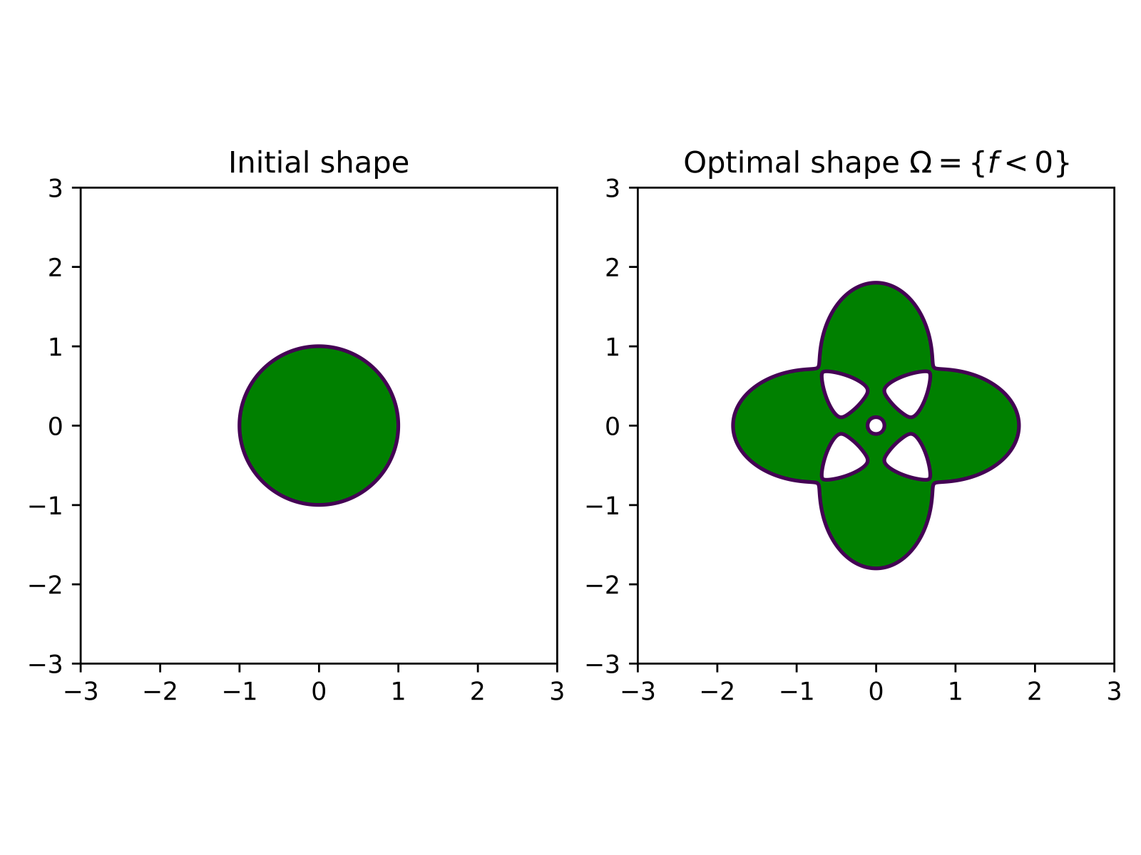

Initial geometry and shape function
We choose \(f\) as
\[\begin{split}\begin{array}{rl} f(x,y) =& \left(\sqrt{(x - a)^2 + b y^2} - 1 \right) \left(\sqrt{(x + a)^2 + b y^2} - 1 \right) \\ & \left(\sqrt{b x^2 + (y - a)^2} - 1 \right) \left(\sqrt{b x^2 + (y + a)^2} - 1 \right) - \varepsilon. \end{array}\end{split}\]
where \(\varepsilon = 0.001, a = 4/5, b = 2\). The corresponding zero level sets of this function are as follows. The green area indicates where \(f\) is negative.

Using SciPy optimize toolbox
We use the package scipy.optimize and wrap the shape functions around it.
We first setup the initial geometry as a circle of radius r = 2.5 (as before)
# The code in this cell is the same as in the example above.
