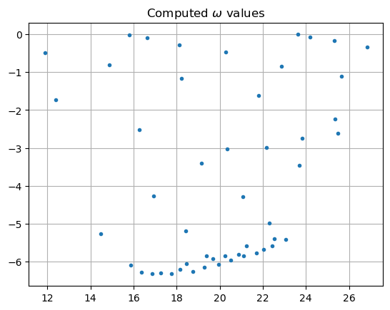

The more "confined" modes have resonance values \(\omega\) that are closer to the real axis. Here are the computed \(\omega\)-values plotted in the complex plane.
lamr = [sqrt(l).real for l in lam]
lami = [sqrt(l).imag for l in lam]
plt.plot(lamr, lami, ".")
plt.grid(True)
plt.title('Computed $\omega$ values')
