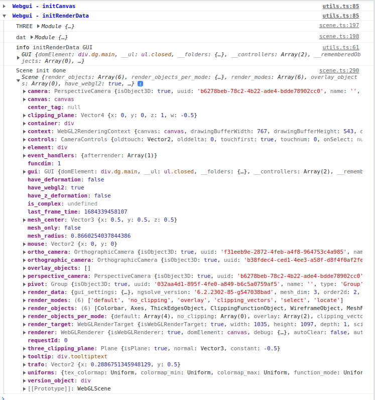

Behind the scenes
To see what’s going on on the client side (the browser), you can have a look at the JS console (F12 for Chrome and Firefox). When you open the Webgui - initRenderData tab, you can have a look at the JS data structures (most importantly the scene object). The render_data member contains the data that was generated by the python kernel and sent to the browser. Some interesting fields are
  • render_data: data that was sent from the python kernel
  • controls: handling mouse events and camera handling
  • render_objects: objects that can be rendered (and turned on/off in the "Objects" tab of the gui)
  • gui: the gui object managing the menu on the top right corner
