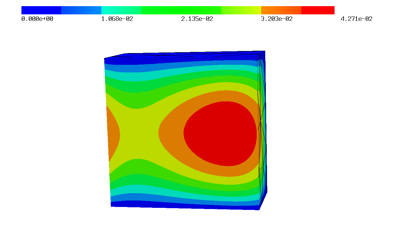

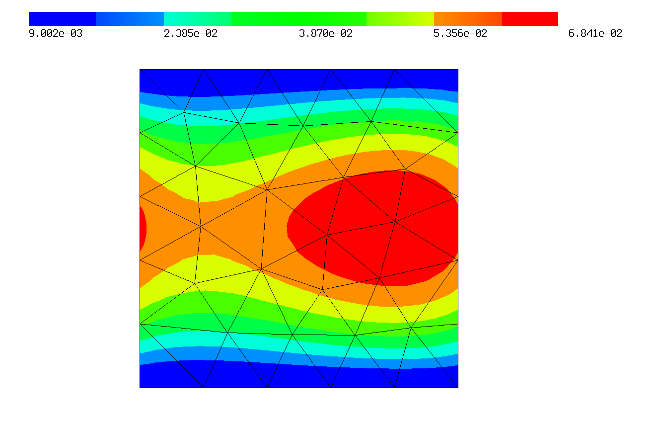

The solution of this problem plotted in 2D and in 3D:
../_images/periodic2d.png ../_images/periodic3d.png
